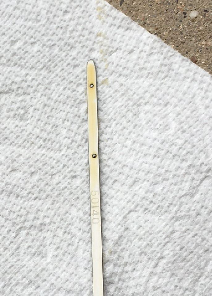

I read that even 1/2 quart too much engine oil can increase engine pressure. This looks like an overfill of about 3/4 quart.
I am unsure how concerned I should be.

Oil pressure wise, this is determined by your oil pump. As long as it has the ability to get oil and distribute it you're fine.
If the crankcase is so full that a) the oil can't return from its journey or b) the oil is in contact w/the bottom of the crank and potentially "frothing" then this could cause an issue. I'd look for foam/froth on the dipstick after a drive.
IMO you should be OK.

I would put a clean catch basin under the car and take the drain plug out. It shouldn't take but a second or two. I'd save the oil and use it another time... or in my chainsaw. :)
Better to be a quart low than a quart too much. The frothing is what I have heard is the problem. The crankshaft is aerating the oil and it doesn't lubricate properly.
These dipsticks are incredibly difficult to read with fresh synthetic oil in there.
My experience, slight overfill and you are ok. Significant overfill and you risk blowing seals like on the crankshaft. Once that happens, you are in for some expensive repair work. Based on what I see here on my iPhone, I would reduce that oil level.
You can either drain some off through the drain plug, or draw some out through the dipstick using a pump and a long straw or tube.

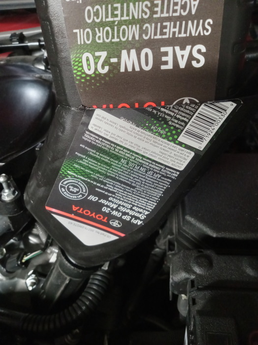

I am sorry to break-in late into thread, it looks closed issue. However, try take oil reading while engine in idle - that's the proper level. And if anyone interested: does someone noticed that thread on Toyota oil quart bottle exactly the same as thread on engine oil filler neck? picture for reference:

OP, since I don't know if you did a wipe off and then a quick insert and removal I will assume you did so.
IF it bugs you enough I would advise draining some oil for max efficiency. It's better to have NOT enough oil vs. TOO MUCH oil in most cases.
You can either crack the drain plug for a moment OR get a vacuum pump with reservoir and pull some out.
Drive around 10 miles and then check the dipstick for any aeration. If you see some then I would advise drawing some oil out.

Yes, with engine cold, withdrew dipstick, wiped, inserted and quickly removed/ read dipstick.

Appreciate the info everyone. Prior to oil change, all old oil was 100% drained. then filled with 6.5 quarts per owner's manual of Toyo OEM oil with new OEM filter. Clearly 6.5 was too much.
Although I would have likely been fine as many have said, I bought a hand pump at Auto Parts store and pumped out 1 quart to get oil level lowered back to the high Fill Line
