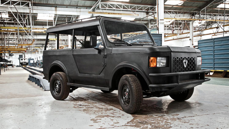

And lastly, there's a reason engineers are not allowed to design pretty things like cars. If we did, they would look like this:
