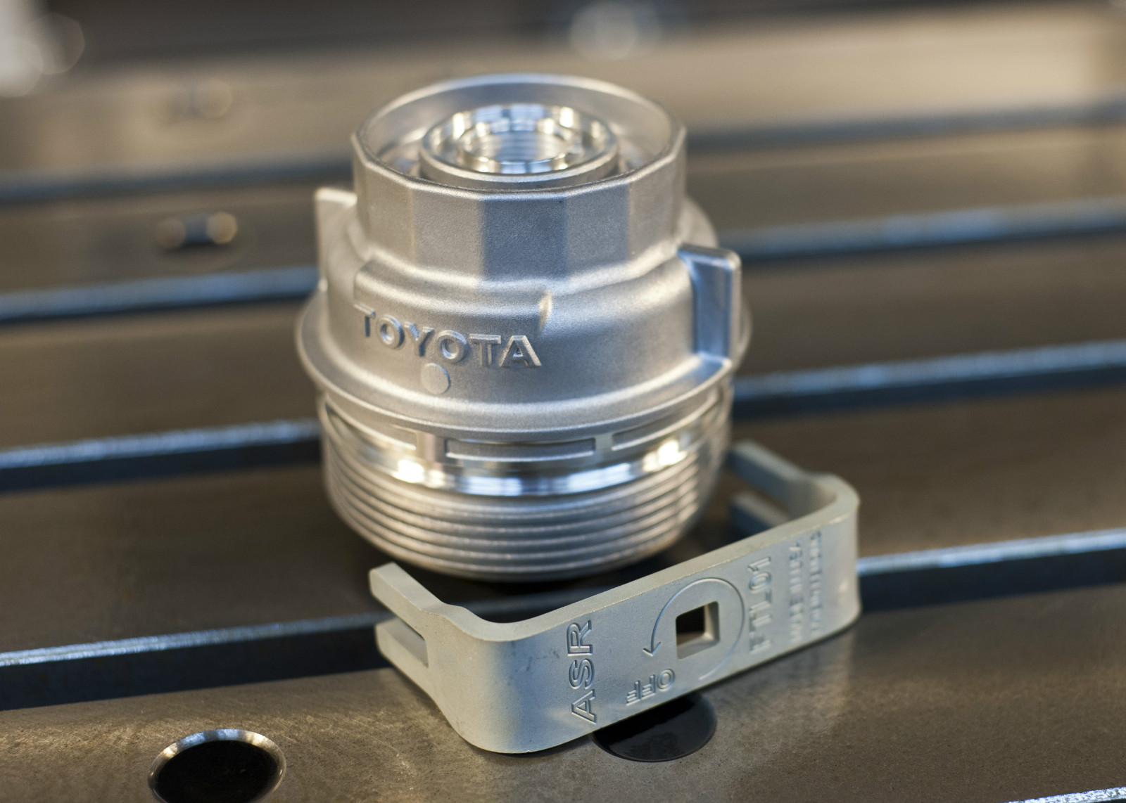

I just swapped over the little metal cartidge piece in the middle. You just bend the little metal prongs to be able to spin the inner piece and remove, with spring. Then swap over and bend back. Super easy and oil changes have been 10x easier since.
Very important little procedure is do as [MENTION=138974]pDubs[/MENTION] did and swap over the little metal cartridge piece in the middle. The aluminum one comes with a shorter piece. Easy swap.

Toyota Lexus Scion Special Oil Filter Wrench Large Tool + filter cap 15620-31060 | eBay

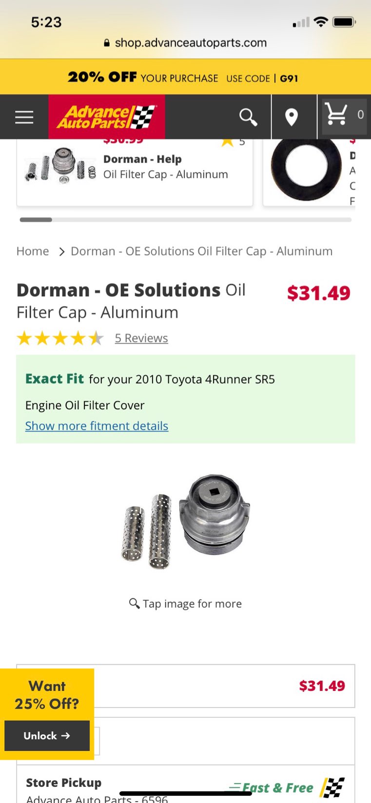

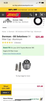

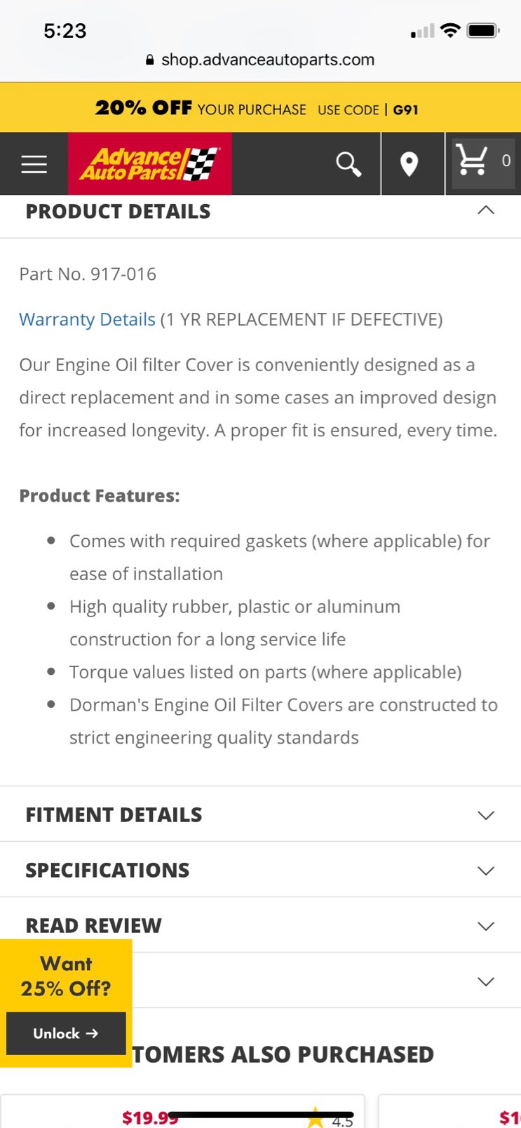

Thanks for this. Like most people, I don’t really have time or options when my truck is sitting around. I found the Dorman part locally and will try it out. Toyota wants (brace yourself) $134 for the stock plastic filter housing. It comes WITH the filter element, though. [emoji23] The parts guy at Toyota and I had a good laugh. He also recommended changing that inner piece and said he’s seen issues where it hasn’t been done. So that was cool.
Anyways, the Dorman part number is:
917-016
