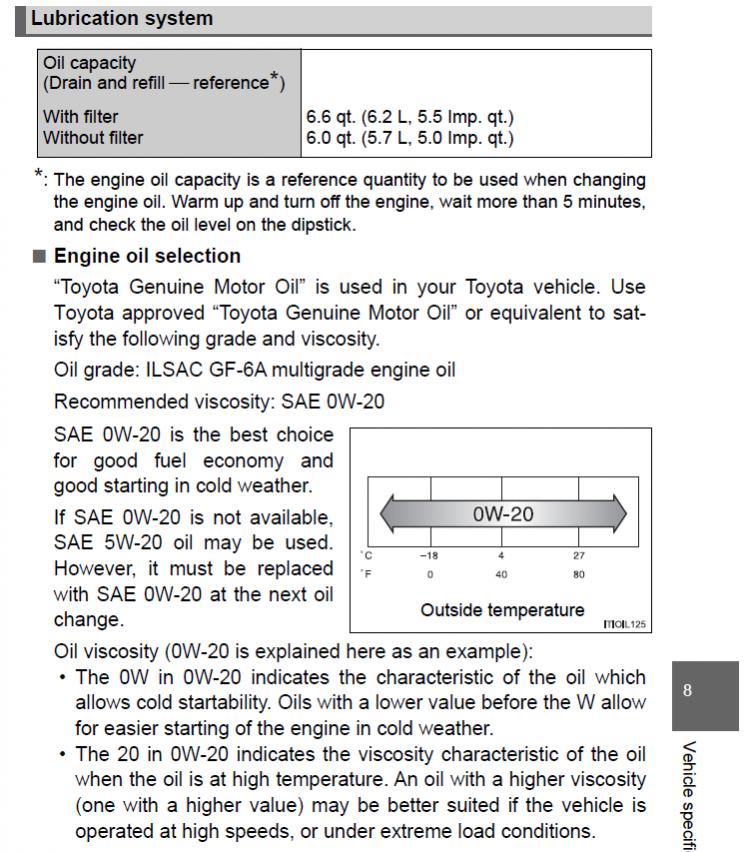

0W20 is OEM and called out in the manual.
Mobil 1 is a great brand - pick it up at Walmart. Wally world is much cheaper than auto parts places. $25 to $30 for 5 quarts iirc.

agree any full synthetic oil 0w-20 should be fine. I usually buy on sale at $21 5qt pennzoil during rebate periods. 2 5qts get a $25 rebate/gc. change every 6-7500 miles.

Buy whatever cheap 0W-20 full synthetic you can.
