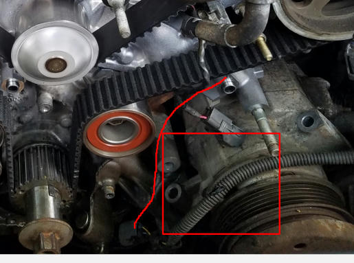

if you are having the same issue and see a flicker it was the wire for me. it was the wire harness that was rubbing on one of the belt drives. it was grounding to it.
Please check all ELECTRICAL connections before assuming the worst like me!
Street fighter, did you have to replace the harness?I'm having the same issues, just noticed your updated status today, and realized my pulley may have cut into the wire harness. It looks to me that the wire harness branches in 3 directions?
Wow same issue, the small 3-4 wire harness should be routed behind the metal coolant line behind the main pulley but mine was in front rubbing against the pulley. if its not cut, all i did was spray plastidip and mounted it correctly.
Looks like my pulley tore the insulation back as well! When my timing belt was done 6k miles ago, it must have been rerouted incorrectly. It's a tight fit, I'm struggling to get it fished down behind these belts and coolant lines now. Thanks for the update, I was loosing my mind over this. I never got the 4-6 psi oil pressure others were mentioning either at idle. More like 40 psi, and 70 to 80 at 3k rpm. I'll update once I get this harness routed and connected.
Just to help out, here is my tear, i dripped plastidip down the tube. the red drawn line should show you where it should be routed BEHIND the metal coolant tube that is bolted to the pump.

Success! That did the trick, my oil light is off now. Thanks again! I was getting a little freaked out that it was something much worse.
