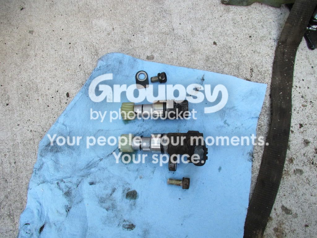

And he also said my speedometer doesn't have a Speedo cable and it's electric. Is that right for a 91?
Well, if there's no cable coming out of the transmission, and the rear of the cluster doesn't have a cable connection for it, its definitely an electric speedo.
Other than that though, I have no idea how else to determine whether yours had electric or cable. I can't tell which one came with electric and which came with cable, but they are interchangeable in a sorta weird way!
See what the cluster has, then change out the gear on the trans to match what your cluster wants. This would be the part (link grabbed from another forum!):

Of course, if yours is just not working, and it did before (assuming the trans wasn't replaced with a different trans that had the other type of unit), could just be that part in the image above that's bad.
