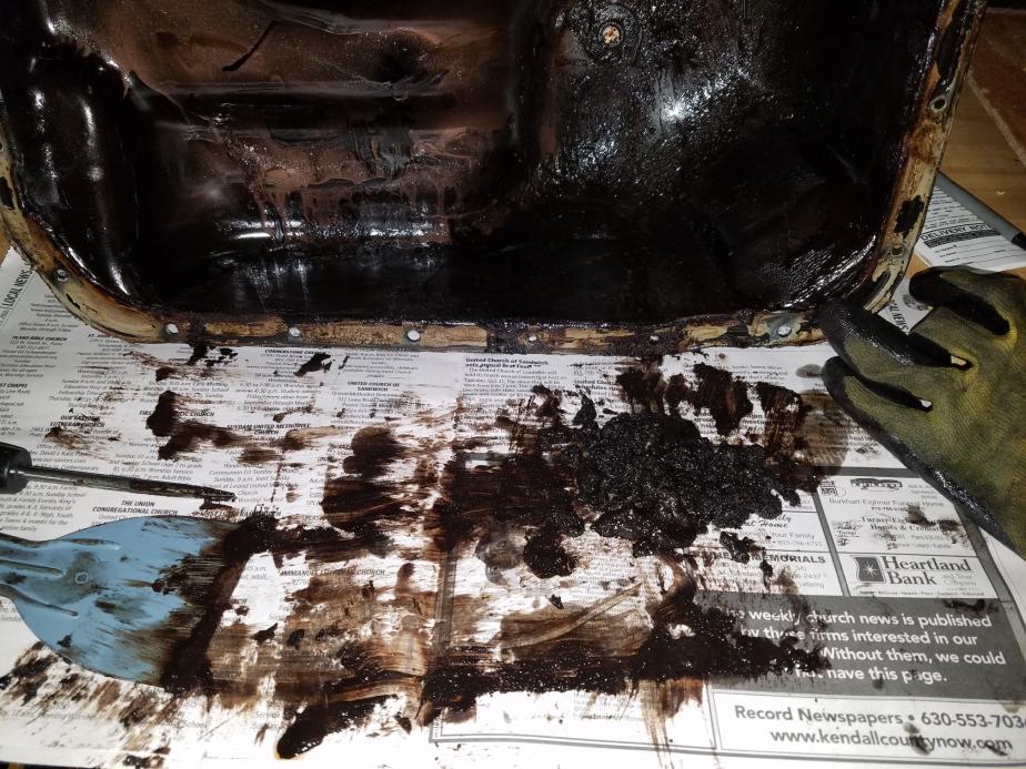

I bought mine with a low oil pressure light so I replaced the pressure sending unit and it still came on after only driving it maybe 30 more miles. Checked the pressure and it was at 0 once warmed up. Turns out the pan was so sludged up that the pickup tube was suffocating. Dropped the oil pan and replaced the connecting rod bearings and its been fine ever since. Wherever the PO was taking it he was paying for a oil "change" only to have probably never gotten them. Glad I got ahold of it because it probably would have ended up getting junked. The crank being cast iron can outlast the connecting rod bearings. Being its a 2wd it shouldn't be too difficult to drop the oil pan and investigate whats going on.
Heres what I scraped out of the pan then had a shop clean it with a high pressure degreaser/steaming machine.
Wow.:faint2:

Wow.:faint2:

Haha yeah I know! Sad part is he was the original owner and it kinda turned into the spare/dog/extra college kids car and they just let it go down hill the last couple years of owning it. I bought it in july of '16 with 187k on it and have replaced, PCV valve, Fuel pump, fuel filter, air filter, Lower connecting rod bearings, cleaned and flushed the oil pan/pickup tube, Oil pressure sending unit. etc. etc. etc. I do have some invoices from the "shop" that had worked on it before and it seems that because of the high labor/parts costs they didn't wanna sink anymore money into it..Which worked out for me because I wrench on ALL of my own vehicles because parts and labor alone can total out what the vehicle is worth which is why they end up in the boneyards. It has 221,5xxK miles on it as of right now and I plan on driving it another 200K. No I don't have any top end pics of the engine unless I end up doing valve cover gaskets sometime soon I will snap a few. As of now I'm running 5w30 synthetic blend and changing the oil/filter every 5k miles. It's been to southern illinois 3 times (5 hr drive), and Nashville tn twice (8 hr drive) since I've owned it. But hey most people blame it all on the vehicle when most of the time its lack of maintenance on their end.
Turns out the pan was so sludged up that the pickup tube was suffocating. Heres what I scraped out of the pan then had a shop clean it with a high pressure degreaser/steaming machine.
Dang! Paying for non oil changes, that blows. The op thought he was doing the right thing. Not!
WOW.. However, doesn't suprized me. People neglect everything. Its sad as ll that needed was normal oil and filter changes and the engine would be clean.
