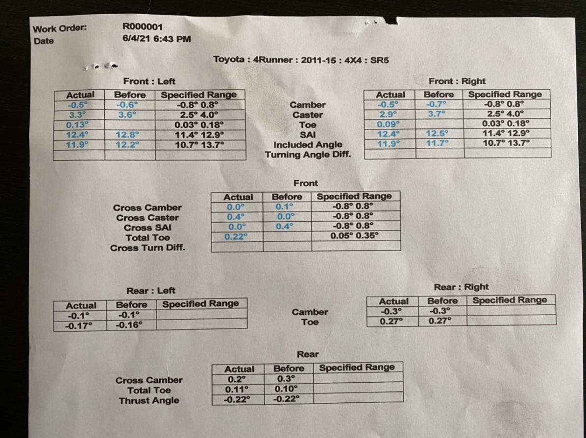

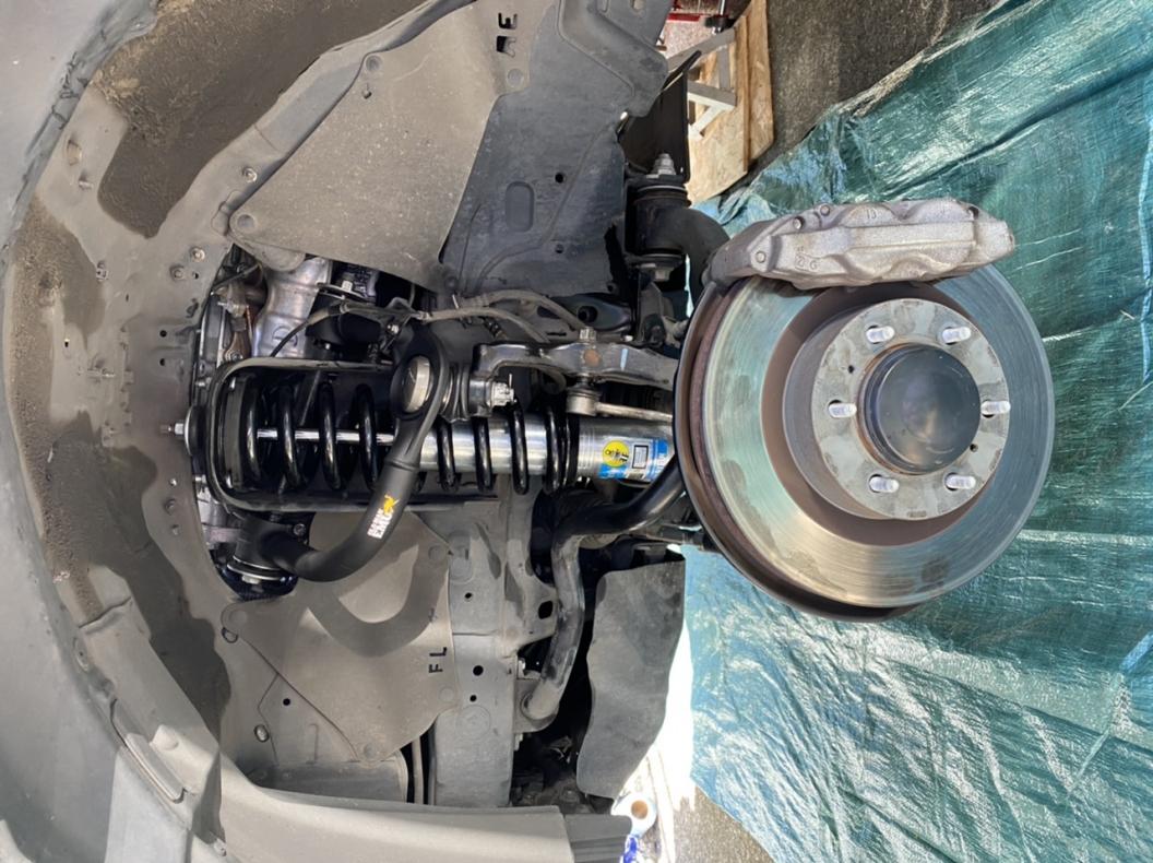

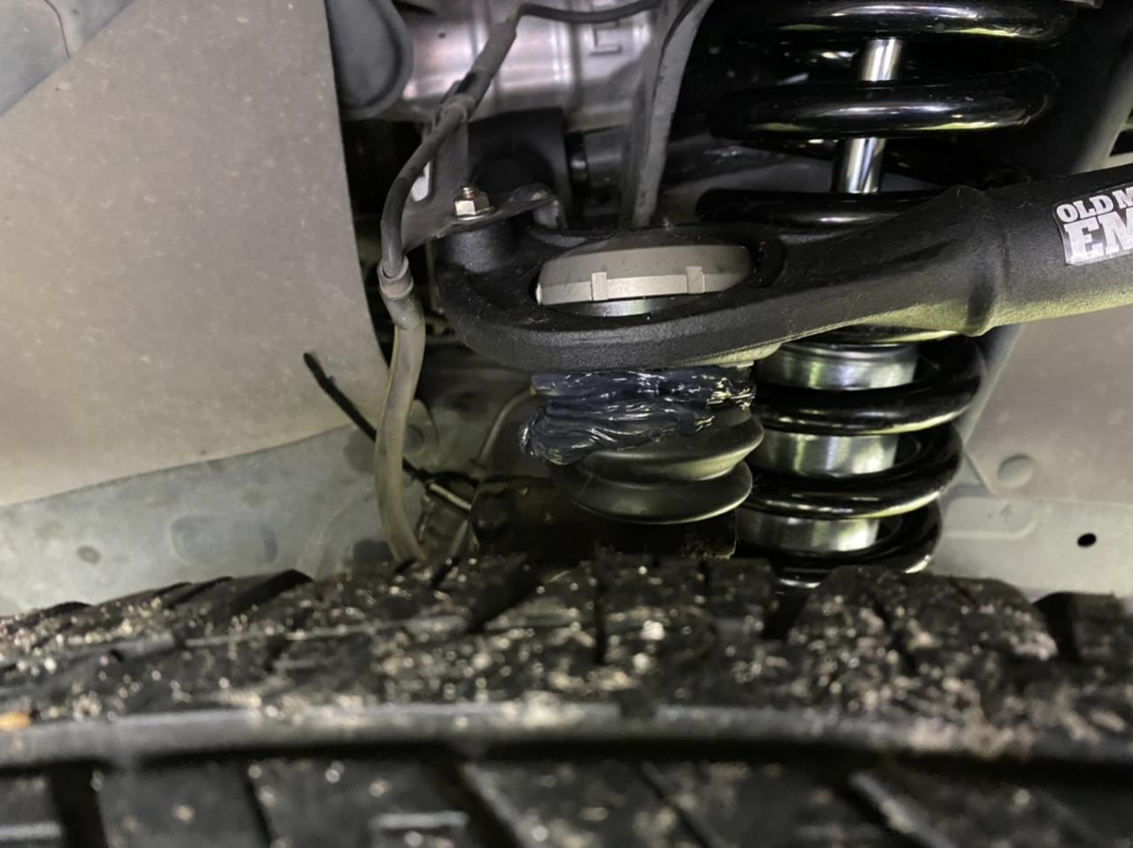

I installed them recently, but I’m still trying to dial in my lift so I haven’t had much time to check them out. Build quality seems great (to be expected from OME). They are greaseable and have a nice cap to cover the zirk. I reached out to OME to find out more info on recommended grease intervals and what kind of ball joint was used and they ghosted me. It’s possible that I greased them too much because I’m a bit newer to being a driveway mechanic.
The garage that I took it to for alignment couldn’t seem to get as much caster as I was hoping for, so my tires rub at the moment. I’m not sure it that’s the garage or the UCA. I’m planning to take to to a different garage to see what they can do.
Sorry I couldn’t be more helpful on it at this time, but I’ll update when I can.
My guess is these probably don't have much if any more built-in caster than oem UCAs. Their marketing literature is almost intentionally vague on the subject...."You can expect between +2.5 to +3.5 degrees of caster with a 2 inch lift." Seriously? +2.5 degrees is below the oem range for acceptable caster. You should be able to get +3.5 degrees caster if not more with oem UCAs on a 2" lift.
You need to find a different shop to align it. They made your caster worse than when you came in, without making anything else better
That's too much grease, the boot needs to be sealed.

They confirmed that there isn’t much additional caster incorporated in the design. +2.5-3.5 is what they are designed for and they wouldn’t recommend more than that. (So, that doesn’t exactly help me out a ton, but I’ll get another alignment from a different shop and see if I can get a little more than current.)

And they didn’t think I damaged my boot from overfilling (shown above), so hopefully that is also correct in my case. I probably would have went with JBAs if my wheels didn’t have 4.75” backspacing, but I didn’t want to chance them rubbing on the UCAs. I’ll keep trying to make my setup work and provide some updates when I have them.
