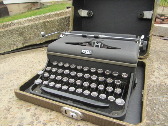

Anyways, here's a picture of the model I have:
(mine is a bit more "dull" & "dusty" looking)
