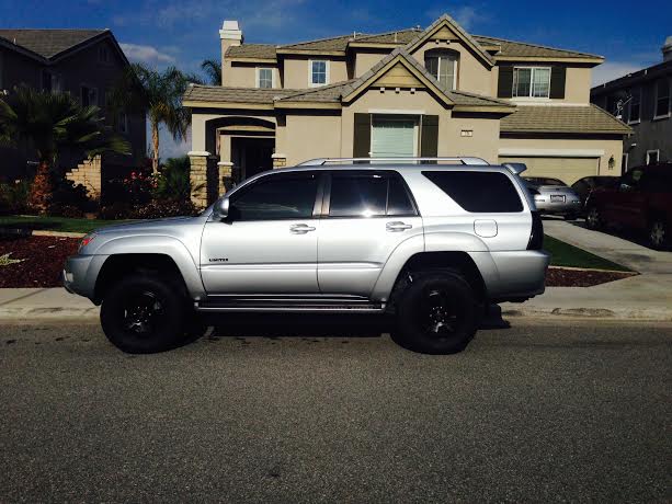

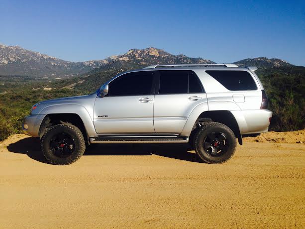

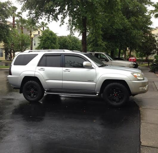

I just installed those springs along with Bilstein 5100's set at .85 and there is no need for spacers. I sit level. Look in the lift thread for my 4runner and see what you think. There is also another lift using OME 3". As airbags have been mentioned, I do agree with that. I am going to be looking into them once I get back to Orlando. I am currently driving cross country and can tell you that this setup is a nice ride and wasn't expensive. I don't know why, but I have never liked the idea of spacers. But that's my personal opinion.
Cheers!!
Once I have the Runner unloaded, I'll take measurements and see where it sits. But it turned out better than I had hoped.

Hey Cory, man your truck looks great. I'm not wanting to get rid of the XREAS until they're shot, so for now, the spacer route is where I'm heading. I was thinking the OME 895's in the rear for more load capacity but as it has been mentioned it might ride like crap. So I think Airlift is going to be the answer.I will stick with the stock setup, add spacers and airbags. That should fit my needs for now. I'm still interested to hear how your setup rides.
