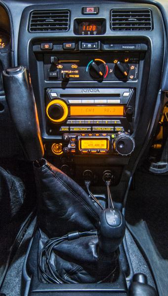

I recommend this ham radio setup, if you are licensed. It works on all amateur bands and you can set up a screwdriver antenna on the roof and talk to other offroaders on the other side of the US or across the ocean. The wattage of course, is way above the CB and FRS radios' limit.

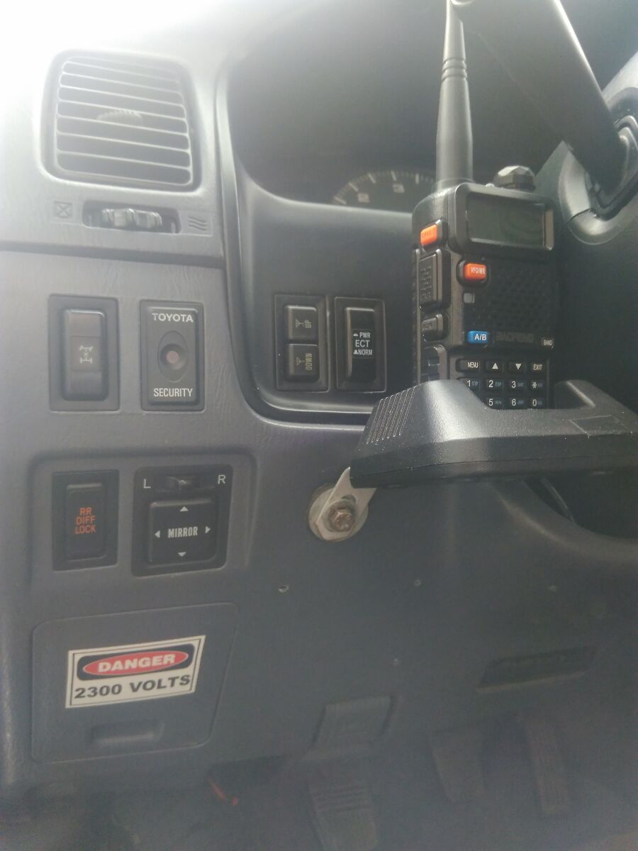

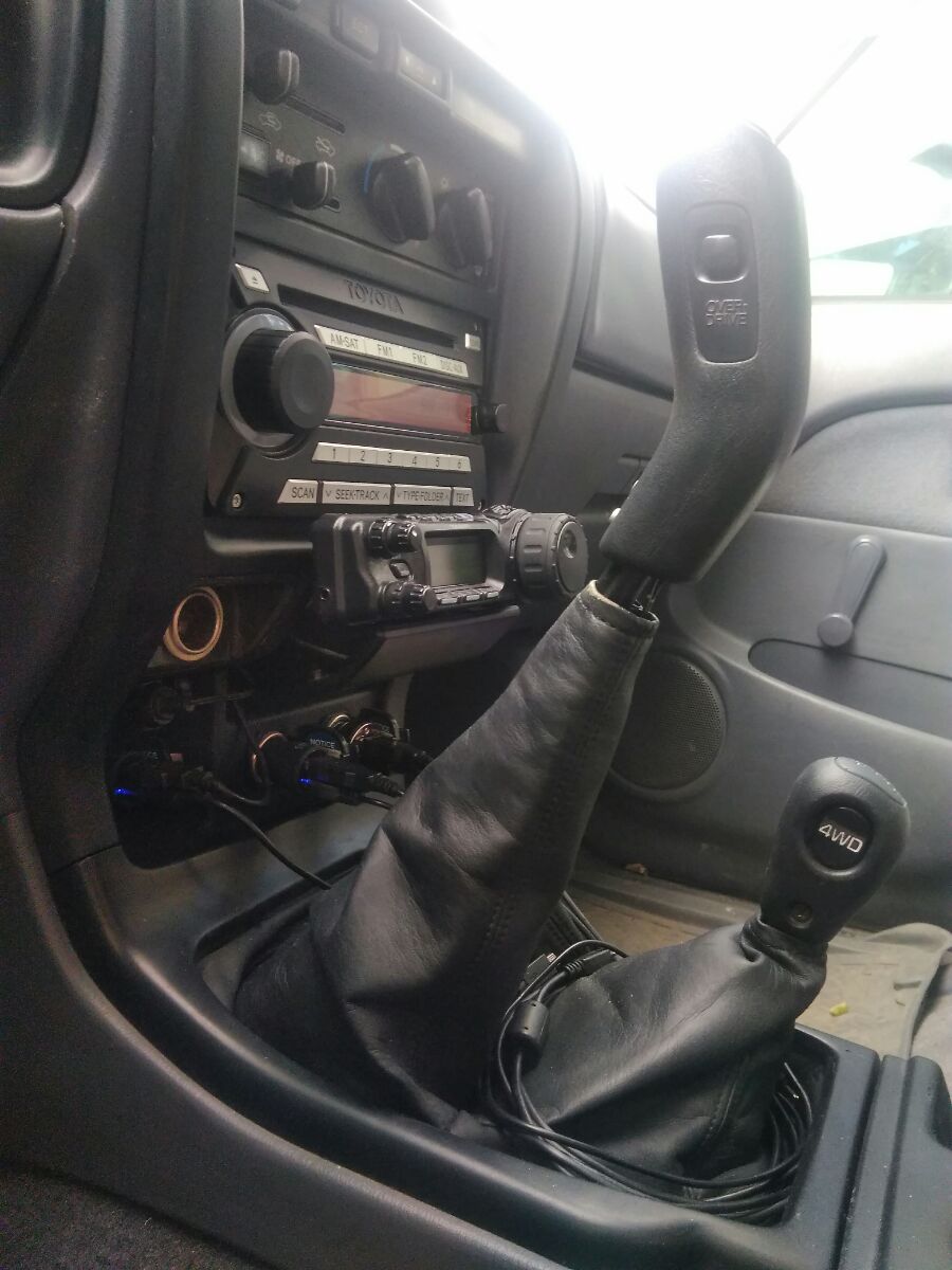

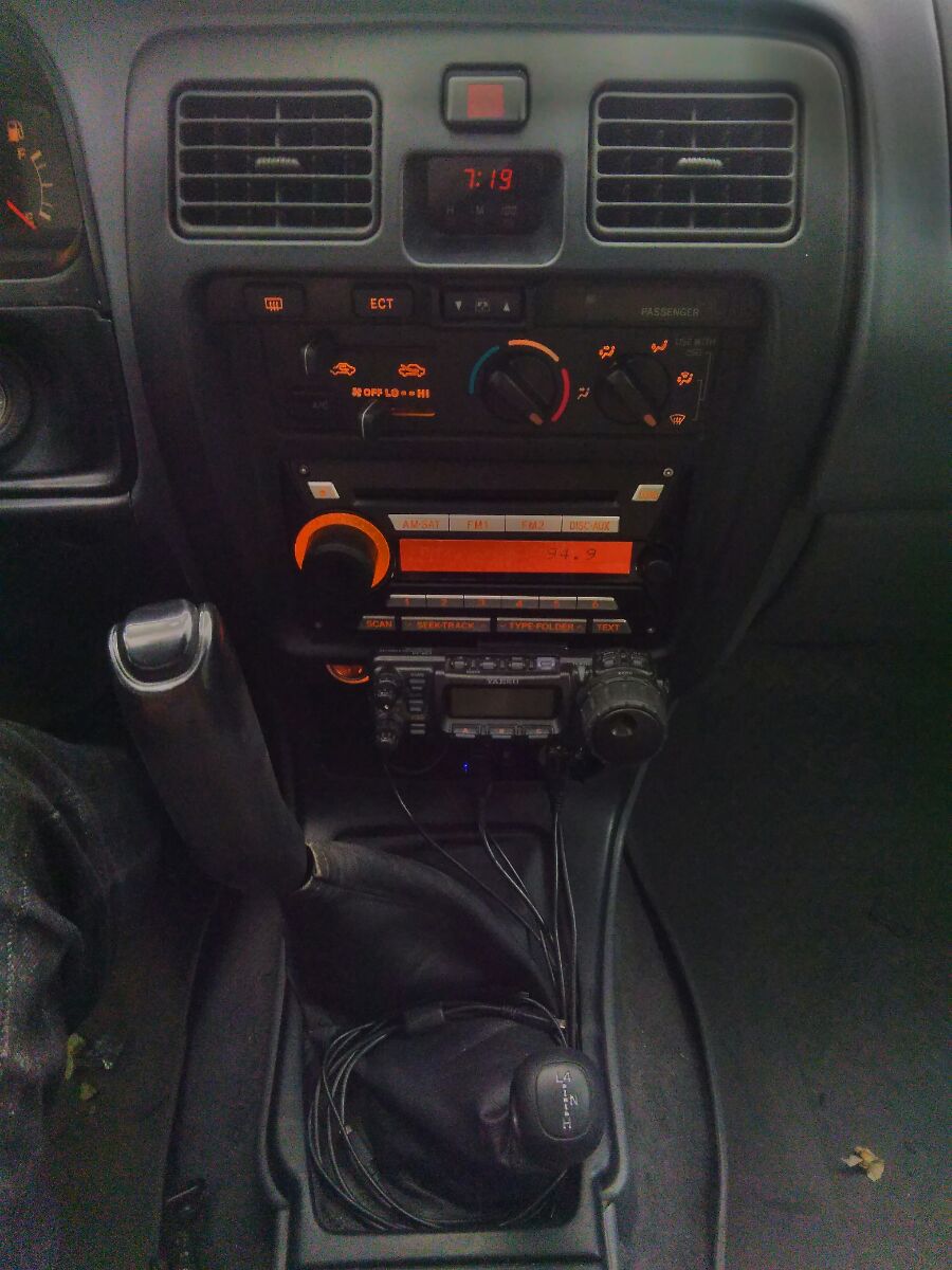

I have a Yaesu 857d and a few baofengs rolling around. Ive routed the external mic PTT to be on the OD button on the side of the auto transmission handle instead of using the original hand mic...which comes in very handy when you have to drive and not let go of the steering and shift lever.
On the left side of the steering wheel Ive set up the screwdriver antenna to be hooked to the toyota radio antenna button, and a ETC button to switch between slow and fast tuning of the antenna with the radio antenna up/down button.
It works nice and is simple.
