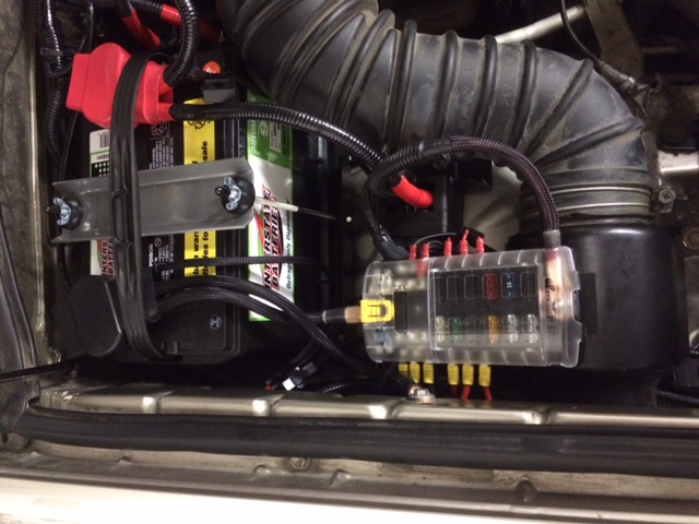

I looked at your pictures... I cant install it there as I have a dual battery setup already... I have have a Blue Sea ACR, LVD, and a fuse panel on the passenger side of the car... I got a lot of electrical equipment like lighting, fridge and communications equipment + repeater so there is no way I am removing (or moving) the 2nd battery.
The only available space I have under the hood is right behind the passenger headlight... but its not enough to fit the 400C or an ARB twin... I need something small or find a new location?

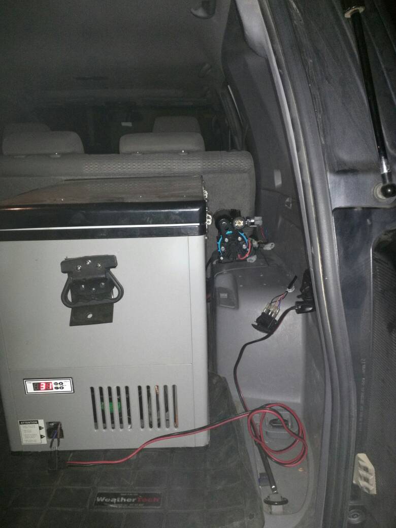

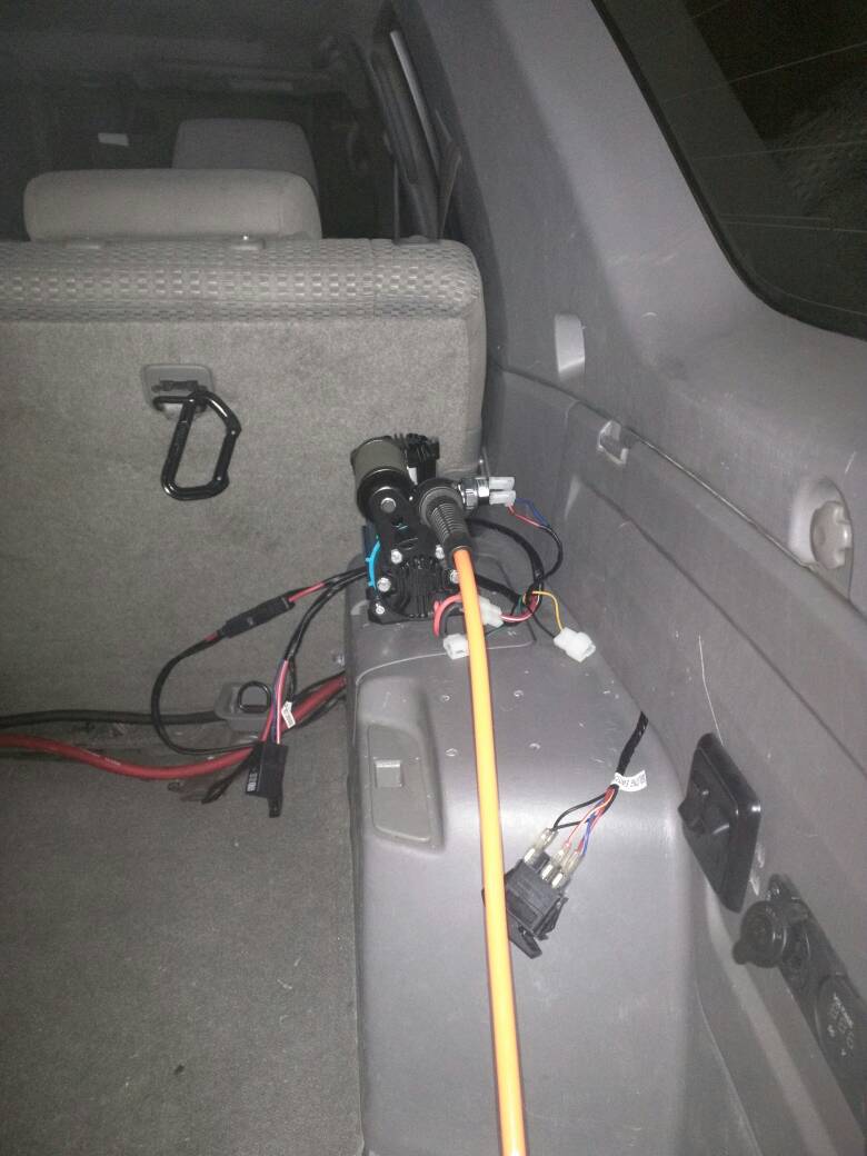

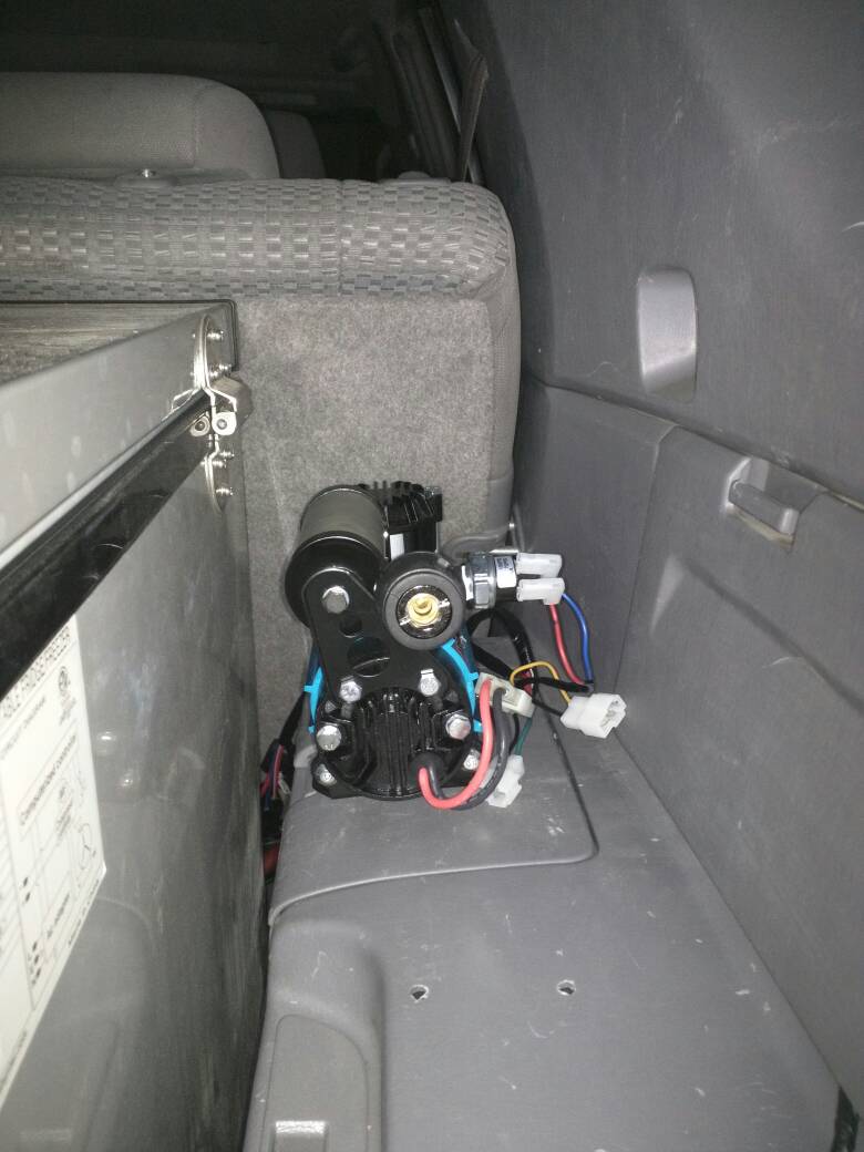

Mounted my single here temporarily. It's going to get its own box eventually when I build cargo boxes.
