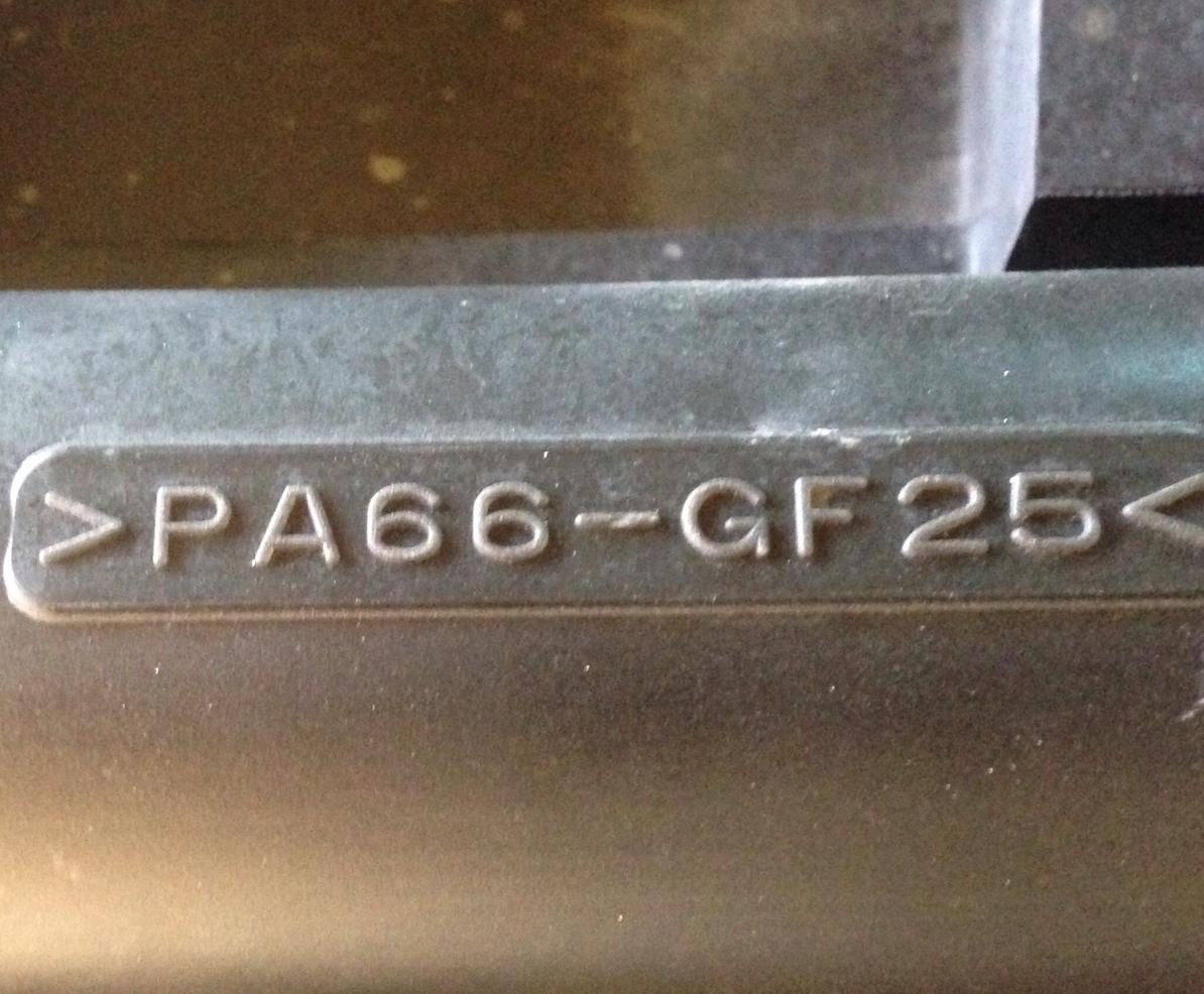

Is there anyway to know if the radiator in my 2000 T4R is original? If it is I plan to replace but if not original I'll keep it a while. It does say Toyota but it could be a factory replacement. image.jpg here's a photo of the only ID marks I see. Any thoughts?

Looks like it is oem. Alot of time toyota is written in white paint on the top plastic tank. All aftermarket oe replacement radiator i have installed have no markings on them.
Is the plastic turning a brown like color? If so replace it. That is a sign of the plastic getting old and can crack and leak soon.
Mine had that on the top and I am pretty sure it was original, about 100,000 miles. And it was turning brown as AZ4Running mentioned. Changed it last weekend.
That number is the type of plastic used in making the tank. (25% glass reinforced plastic. For the GF25 number) and the type of resin is the other number.
The plastic does not look nearly as brown as the photo-still much more black than brown. At 150k she'll be getting a new radiator anyway, sooner than later. Thanks.
