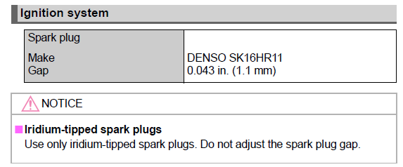

My 2023 ORP's owners manual says -I assume the 21 ias the same:

I don't know what plugs I have, I'll have to look in the user's manual. I'll get back to you. Probably the same as above.
Thank you guys! I looked at the wrong (4th gen) manual, my 5th gen manual shows the same as FoxtrotRomeo, sorry for the confusion. Looks to be iridium plugs, so no need to change for a while like you all commented. Thanks again guys!
