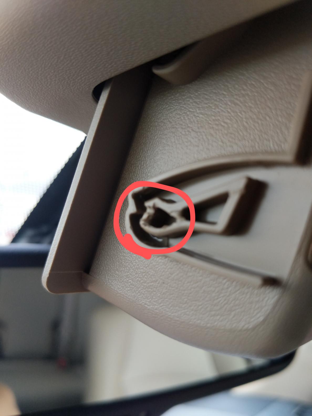

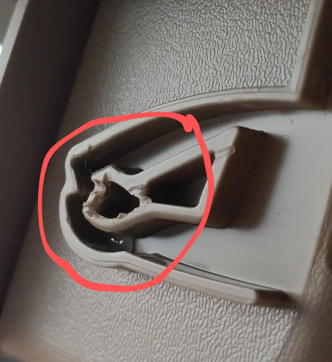

Having a similar issue with 2016 4Runner. The plastic on the inside of the drop-down holder is deformed where the pin rides around the edge and locks it into place. When it's warm, the pin slips right through and it won't stay closed. Toyota wants a couple thousand to replace the entire overhead console when it's technically a minor fix. I feel like the holder itself could be replaced. Suggestions?
