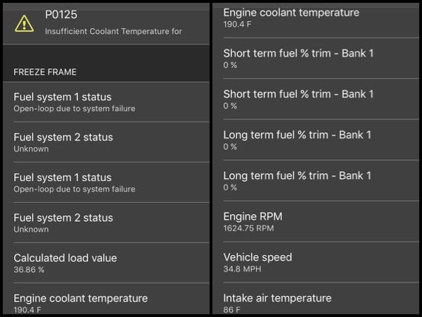

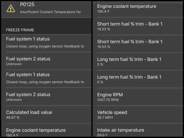

Greetings Compañeros,
Been chasing codes with this Runner since our paths crossed a year and a half ago.
Down to the last one, the illusive P0125...
Often together with P0130 and P0133, sometimes with P0171.
I've replaced both o2 sensors, cleaned, swapped and checked the MAF and blown smoke into the intake in search of leaks.
She runs pretty smooth but the MPG is embarrassingly low.
We have conflicting Freeze Frame Data:
...Could the ECU be batty?
Today's discovery was that the cooling fan does not spin freely at all when the engine is off and cold.
Could a sticky fan clutch be the root?
So, the reason I'm thinking the ECU may be whack is because the Fuel System 1 Status alternates between 'open loop' and 'closed loop' in the separate Freeze Frame Data. Is that logical?
