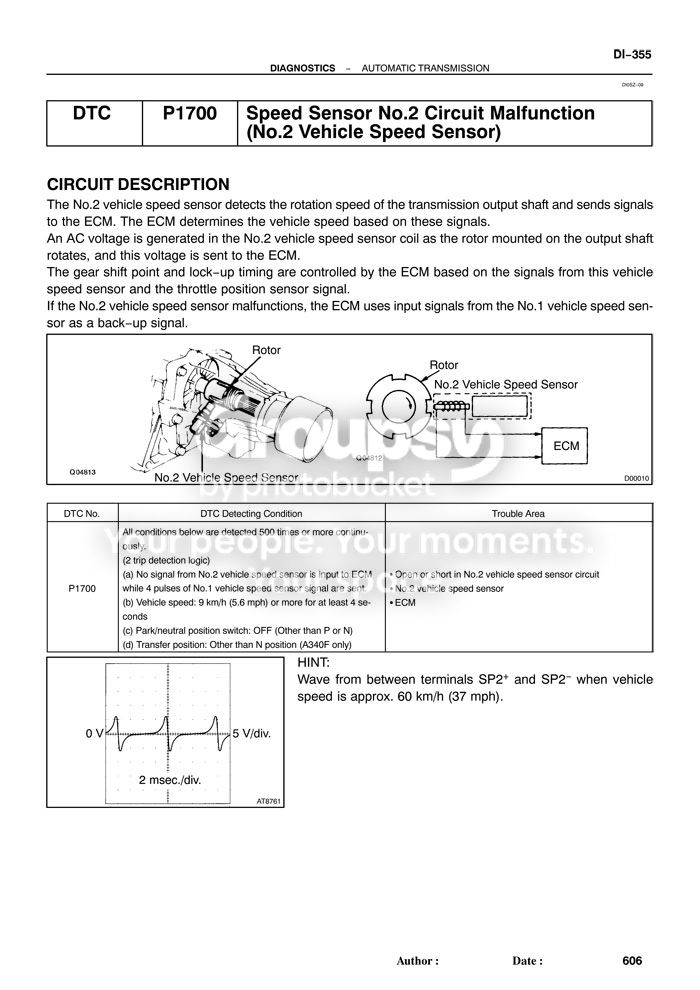

From the 2002 FSM: p1700 Speed Sensor No. 2 Malfunction. I think its on the back of the transfer case, right before the drive shaft.

Some info for you!
On your 1999 4 cylinder:
P1700: Automatic transmission (A/T) vehicle speed sensor #2
Vehicle speed sensor #2 is a two wire speed sensor located on the transmission tail shaft. Vehicle speed sensor #2 wire colors are Yellow/Red, White/Red.
(note so you don't get confused)
Vehicle speed sensor #1 is a three wire speed sensor also located on the transmission tail shaft. Vehicle speed sensor #1 wire colors are Black/Yellow, Pink/Blue, Gray/Blue.

I just had this same code thrown on my 1996. Being a beginner at all things mechanical and whatnot I came here! Thanks for that info, now I just need to get that part ordered and scratch my head for an hour until it gets fixed! :)
Edit: Well, it turns out I need to replace my Neutral Safety Switch. Glad I didn't buy a VSS since I'm a little low on funds right now. Extra thanks now to EatonKyleH for posting that! Went to check if my car would start in neutral and guess what....she did!
