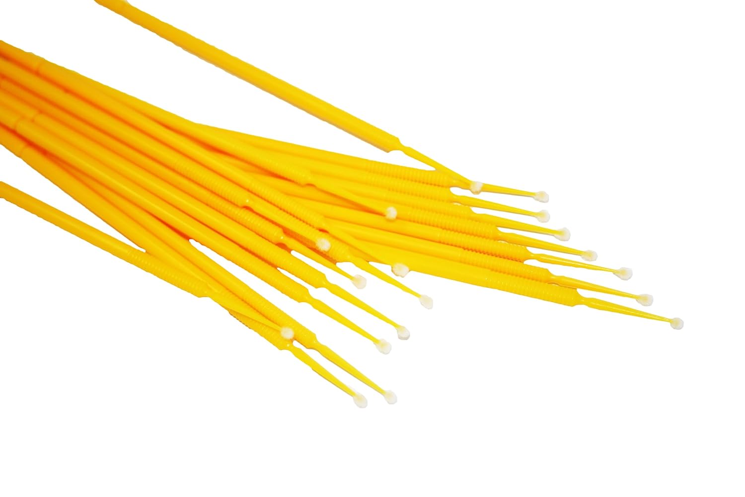

flyinhawaiian01 - I like your idea of the q-tip. I picked up some of these paint applicators on amazon that work great as well.
http://www.amazon.com/ABN-Detail-Di...&redirect=true&ref_=oh_aui_detailpage_o05_s00
When I got them they were a little cheaper I think, but still the convenience makes them worth it IMHO.
They give a lot more control than the applicator brushes on the touch up pens. I will try out your idea when I run out.

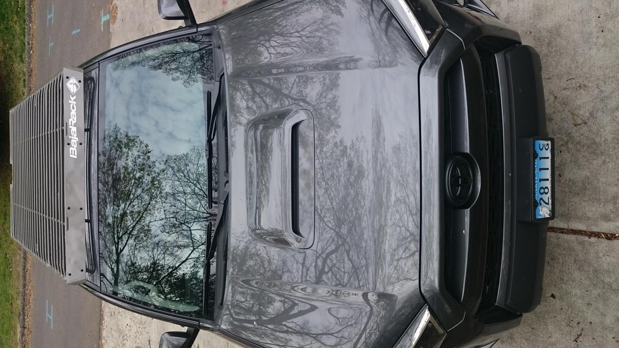

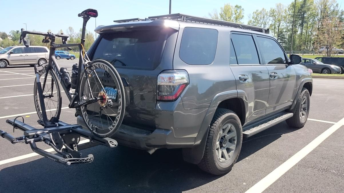

Thanks for the info guys. The idea of trying plastidip black on the front intrigues me. For those of you that have painted yours black, you mind posting a couple photos?
I did mine in black. I think it looks much better than the silver.

Did you dip yours or paint them and if you dipped it did you take them off to do it?
I used the Rustoluem version of PlastiDip. It went on very well in several thin layers. I left everything on the truck. It masked off pretty easily with painter's tape. You can stick playing cards behind the trim wherever it's difficult to get the tape just right. I also covered the surrounding areas with plastic sheeting just to make sure there was no overspray going on the body. It was crazy easy to do, and didn't take long. I've been through the car wash with it multiple times with no issues at all. It's held up great so far.
