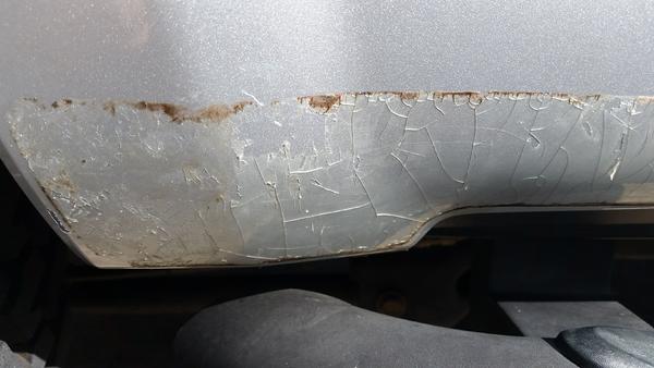

My '06 Sport has about a 3" wide strip of some kind of film along the bottom of all the doors. It has long since deteriorated to the point of being a web of cracks and lines. I watched a bunch of youtube videos on removing this sort of stuff on motorhomes and the like. I've tried a heat gun and plastic scraper with mixed results. The old top film just came off in tiny chunks.
At this point I think what's left is mostly adhesive. What products/techniques has anyone used to remove the rest of this nasty stuff? I've been using goo-gone adhesive remover with poor results. I'll hit it with a pressure washer too. Any other recommendations on getting this junk off the plastic trim?

So I picked up some Goo Gone Gel last night along with a 2" wide plastic putty knife. I had high hopes that just a bit of scraping, some Goo Gone, and a bit of blasting with the pressure washer would do the trick. Well, not so much.
Here's the "Before" shot:
Then after a bunch of spraying with the Goo Gone, scraping with the putty knife, and finally more scraping with a Scotch Brite "Dobie" pad. You can kind of see the work in progress.

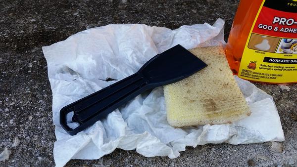

And....my "tools":
I've probably got an hour invested in doing that back door and half the front. At this rate I'll have a good 3 or 4 hours total just getting this crap off. The first photo looks "good" actually because that's after soaking overnight with Goof Off and hitting with the pressure washer. What was there before was kind of a doo-doo brown strip because the mud just stuck like glue (literally) to the exposed adhesive.
The top layer comes off in little flakes, even though it's over 80F outside. I tried some work with the heat gun last night. Since the top layer of film already pulled off the heat just makes this other layer and the adhesive get gummy and sticky but doesn't really come loose. I did get one spot too hot and it jacked up the paint a bit. The rest of my truck has plenty of trail striping and never sees wax but this skidmark along the bottom of the truck just really was bugging me. I've got a lot of work left but it will be much better in the end.
