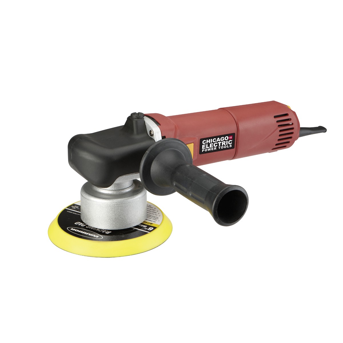

- needs a D/A sander to remove, using 6" abrasive discs...240/320/400 grit
- epoxy primer if any spots are sanded, to bare metal
- and a bc/cc repaint
Chicago Electric Power Tools - Item#69924 - 6 in. 5.7 Amp Heavy Duty Dual Action (D/A) Variable Speed Polisher
6 in. 5.7 Amp Heavy Duty Dual Action Variable Speed Polisher
Get smooth, swirl-free finishes with this powerful 5.7 amp dual action polisher.
Two-way action creates a random orbit pattern for a glass-smooth finish. Cuts through oxidation without harming paint.
Dual-action random orbit
Runs at 2000-6400 OPM for optimum polishing
Six variable speed settings
Two position side handle
Hook and loop pad attachment
^^ This Harbor Frieght tool rocks - in backyard body work and wood refinishing....comp at $149.99 Only: $59.99
