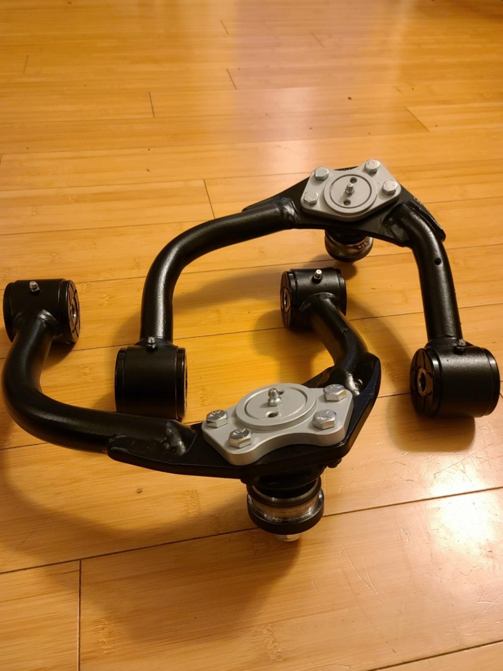

I painted mine black, they look a thousand times better.
Will upload a pic when i get home, it's not on my phone anymore
Edit: found it
Edit: found it
Thanks for the pic. Nicely done. They look awesome. What kind of paint / prep work did you use?
Used rustoleum farm implement if I remember correctly. Had no prep beyond a light sanding and taping off whatever I didn't want painted
Ah sweet. How are they holding up? Any chips?
Nothing yet! Only been about 8 months or so but they're holding up well. Farm implement is pretty tough stuff and is pretty chip resistant. You gotta learn to work with it though, unlike other spray paint that will usually even out and blend as it cures farm implement is not nearly as forgiving and really likes to dry however it was applied. Also very finicky in regards to how thick it goes on - even the "low gloss" shades will shine if you lay them on too thick. So take your time and make sure your last couple coats look good if you're picky like me
Of course a way around this would be to use farm imp as a base coat and something else for a top coat, but that depends on how much effort you want to put into repainting them. May or may not be a little redundant in your situation. There are certainly other durable spray paints around that would suffice just as well; I just use farm implement a lot, had some laying around and it was the best choice from what I had in my garage
