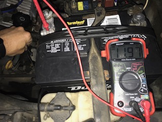

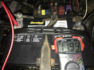

When I put the multimeter on positive and then on the casing of the alternator, I get a voltage reading. Is this indicative of a short? Should I replace the Alternator?
The 11.97V picture attached is the alternator casing to the pos battery cable. 11.99 was a few moments after cutting the truck off. When I came back 30 minutes later, it was 11.88V.

Alternator casing is usually Ground. Check for resistance from alternator casing to negative on the battery. Should be very low resistance.
