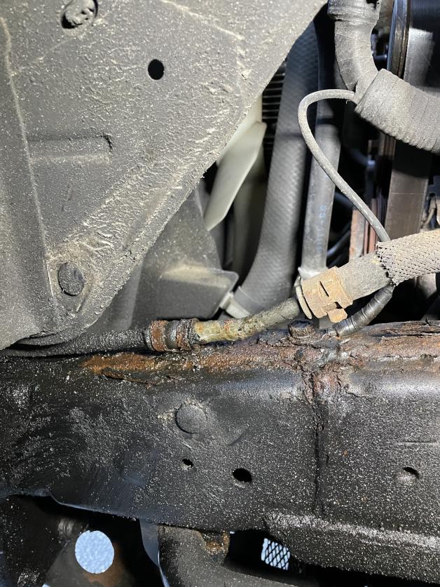

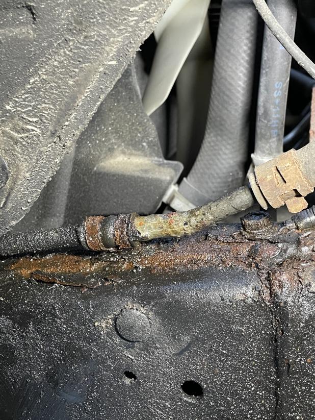

I have what looks like a slow oil leak and it seems to be from this line, probably from corrosion, but I cannot identify it and haven't dove into the issue yet.
Looks and smells like engine oil. Drivers side frame rail 12" before the radiator.
2010 SR5
Thanks
ETA: Most of that juice in the pictures is Fluidfilm fwiw.
I think you have a power steering leak. it looks like that is the same spot mine ruptured almost 2 months ago but it might be a bit closer to the radiator than mine was - it's hard to tell with only those pics. that fluid would be transmission fluid which is used in the powersteering

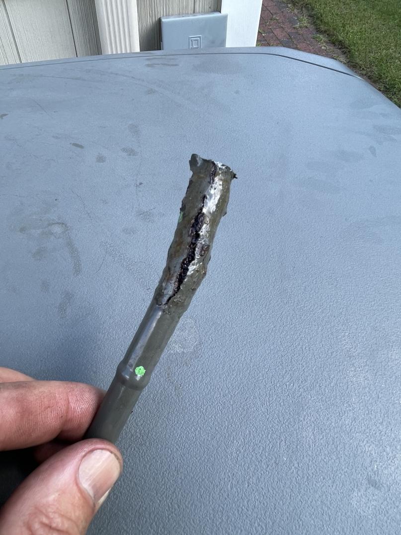

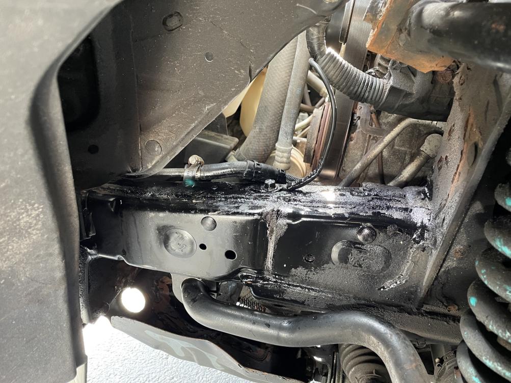

Yes, that's exactly the same issue and part. Thank you very much!!!!
Ended up just cutting back the line and stretching the hose a bit. At some point I will buy some hard line and make a new section. No way I'm paying $100+ for this.
As a bonus, I flushed the PS fluid, which was needed.
