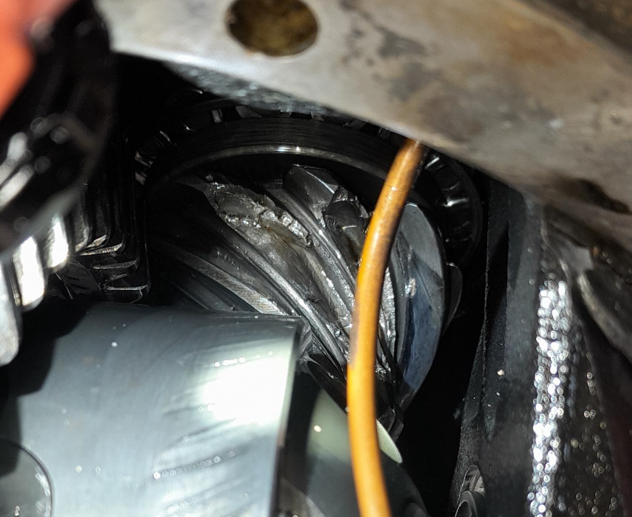

if I had to put my money on it.. yea.. i'd say you busted a tooth or two on the ring gear. Unfortunately that's literally that sound I had in my supra when I blew the ring gear out of it..
I'm not a diff expert... but I would think/hope that if it is the ring gear it could just be a fairly "simple" swap out without having to re-shim and all... but may be more safe to also replace the pinion gear (unless that's what went to began with..).. it's hard to know what sort of damage the broken off material does in there once it's loose. If you haven't already, drain the fluid, you're bound to find some chunks come out..

It's weird that the diff makes no noise in reverse....

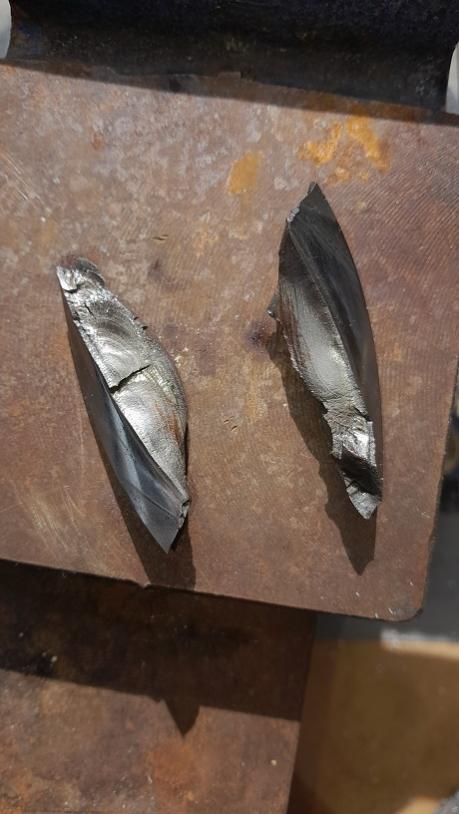

that's very likely due to the way the gears are cut. It could just be a partial tooth break. I could be wrong.. but I would legitimately be surprised if the sound wasn't directly from a hurt ring gear.

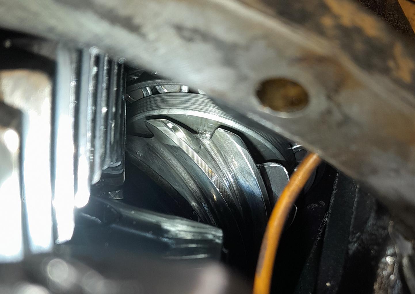

Pinion gave up. Ring gear looks ok. 1st pic is the good side, 2nd pic...not so much.

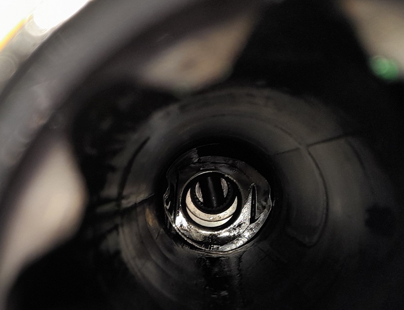

Had the diff reinstalled and passenger axle engaged, driver side not so much. Internal oil baffle was loose. Never knew to check for that.....inexperience has it's draw backs.
