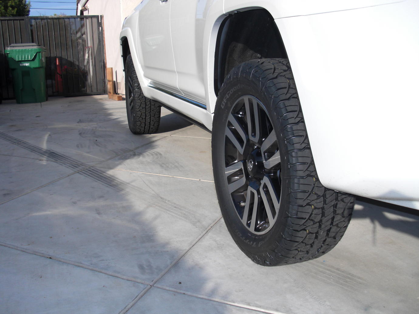

I have 275/55 BFGs and I'm very happy I got them. They are nowhere near bulging on the rim but are still wider then the Yokohamas which where definitely more pavement oriented. Definitely a beefier look.
