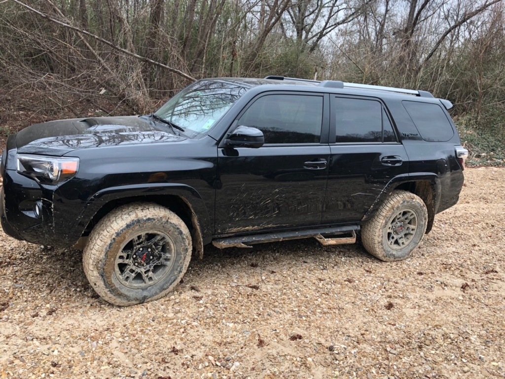

Does anyone else's paint look like this after hitting the trails? I guess it's just the price you have to pay if you wanna see these amazing places off the beaten path. Time to find someone to compound them out.
Some of those are just dust but some will be deeper and more or less permanent. My last 4runner looked like this but my 14 I stay away from the brush.

Even with the dust the OP do look pretty bad. Were you driving through the bushes? :zoom:

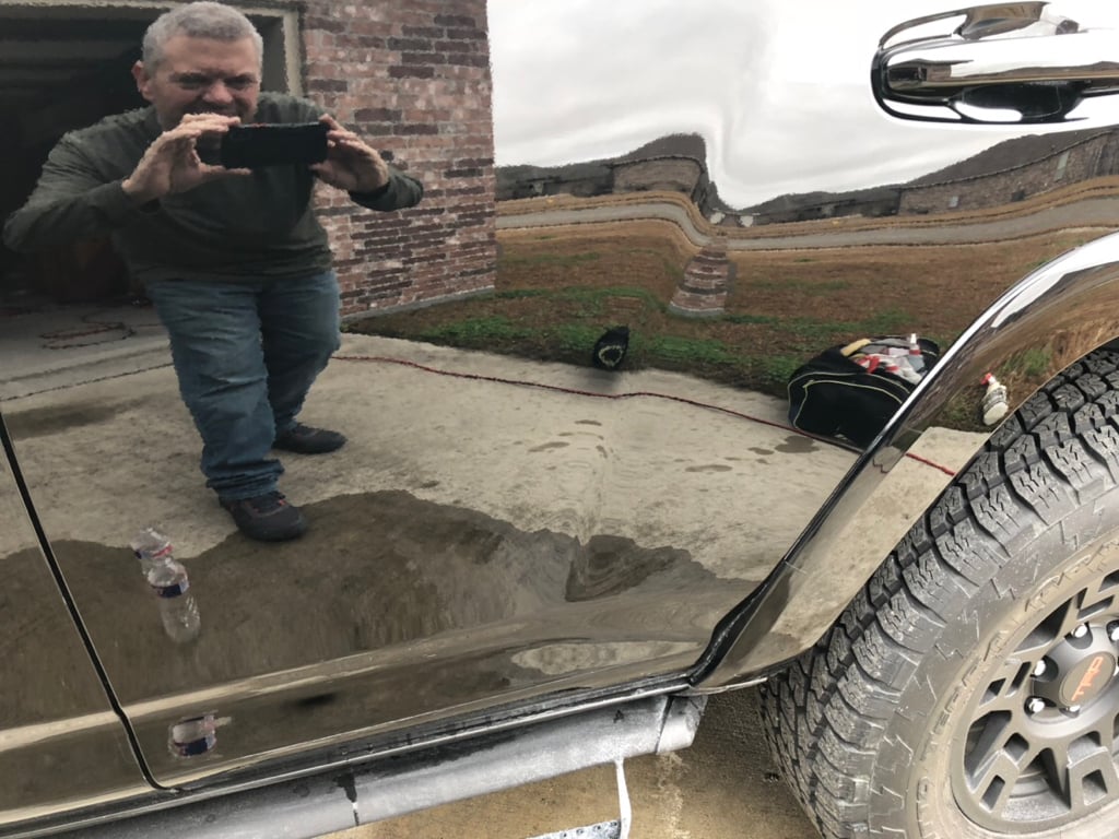

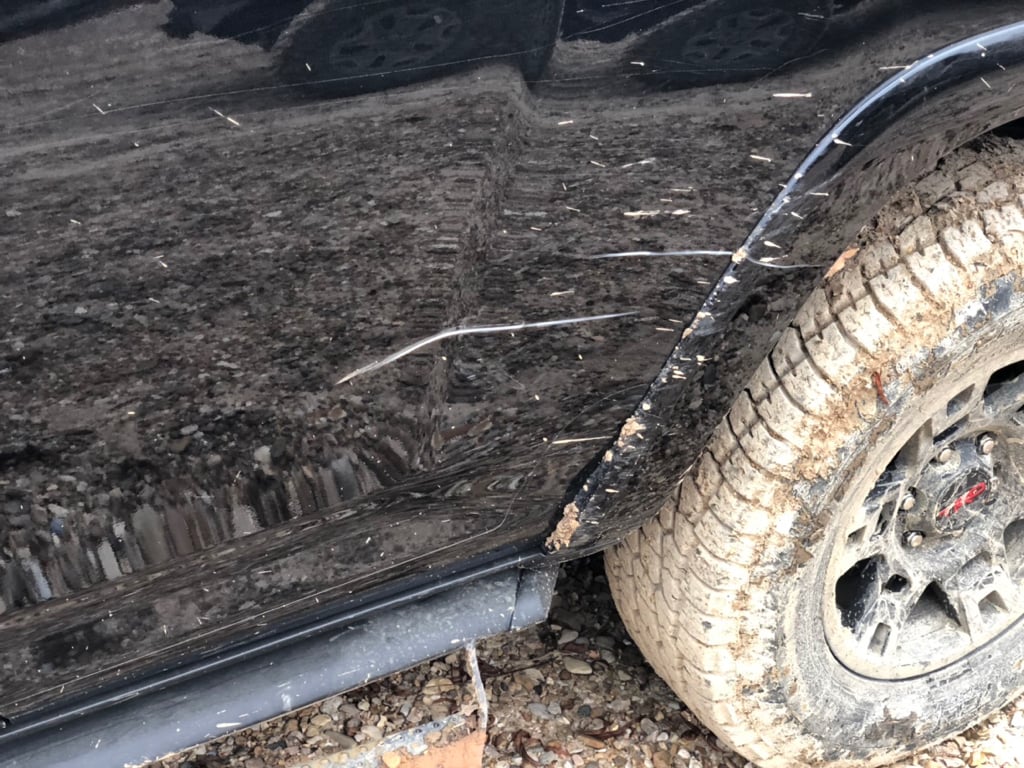

Wet sanding will get most I if not all of those out. Just remember you only get so many times to sand it though. I scratched the crap out of the wife's 18 Pro when it was 2 weeks old. Tried full out rubbing compound but no luck. I had to wet sand it but it came out looking better then the rest of the panels.
Those will buff out. Trees, especially large ones, leave dents that don't buff out. Or rocks, so, get some polish and fresh elbows and get to work.:whip:

Yea the majority of those are from our visit to Big Bend Ranch State Park last week from the typical brush on the trails. I didn't find any dents or anything that deep so I know that most will come out with a compound, but I wouldn't be surprised if a few require a wet sanding. I love black but I hate it too lol. The only way to truly guard against this is with a vinyl wrap.
What you did was scratch the clear coat, not the paint. If you don’t know how to do it correctly find a guy who knows how to properly use a buffer.
Basically, you heat up the clear coat and then even it out. Just be warned that after a few more times there isn’t much clear cost left to even out.
Wow! You ARE good!
You also beat me to the scratches. Mine had 3 weeks, you managed in 2!
Wow! You ARE good!
LOL Thanks!!
Also managed to rip the running boards off on the same trip. Needed sliders anyway right?!?!
