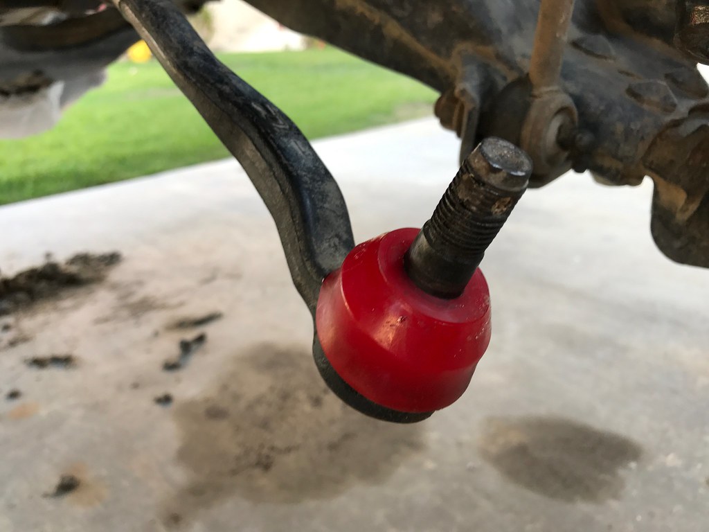

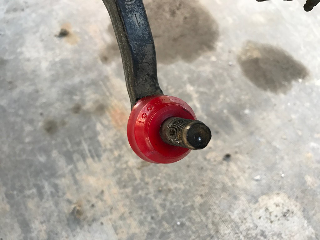

Are you talking about the Energy polyurethane boots? They are extremely durable and I am using them on another vehicle in which the tie rod end boots cracked. The problem is, they are slip on only, which over time allows for water/dirt to get in. I had to do a drill + tap on the tie rod in order to push grease in regularly to flush out the joint.
The thing is that Energy Suspension does not offer an application specific boot for this platform, you would be using a universal boot at that point. I have them on my tie rods.
They will definitely outlast any rubber boots but as mentioned, they don't seal along the bottom edge, instead slide over. I have yet to have contamination issues, but I've only had mine on for a few months. The old boots were torn and there was plenty of crap already in them, so this was an upgrade.
