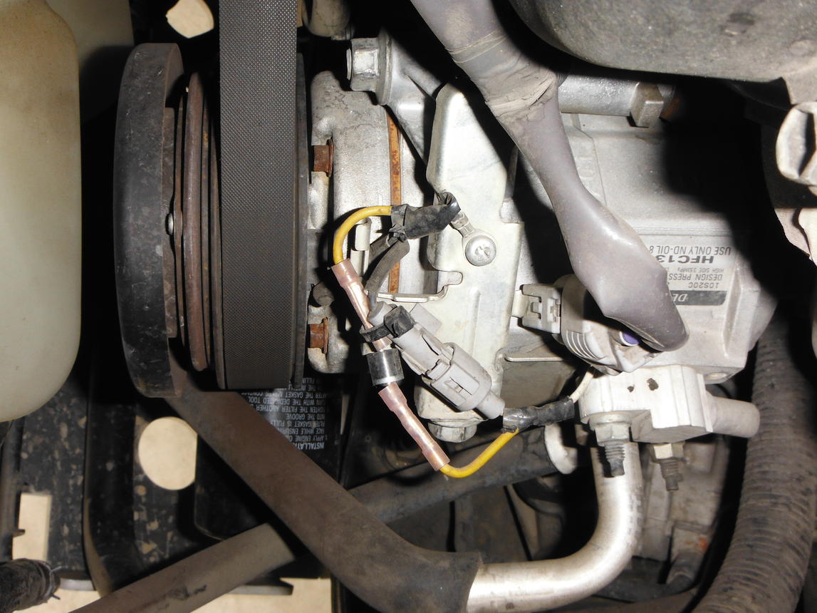

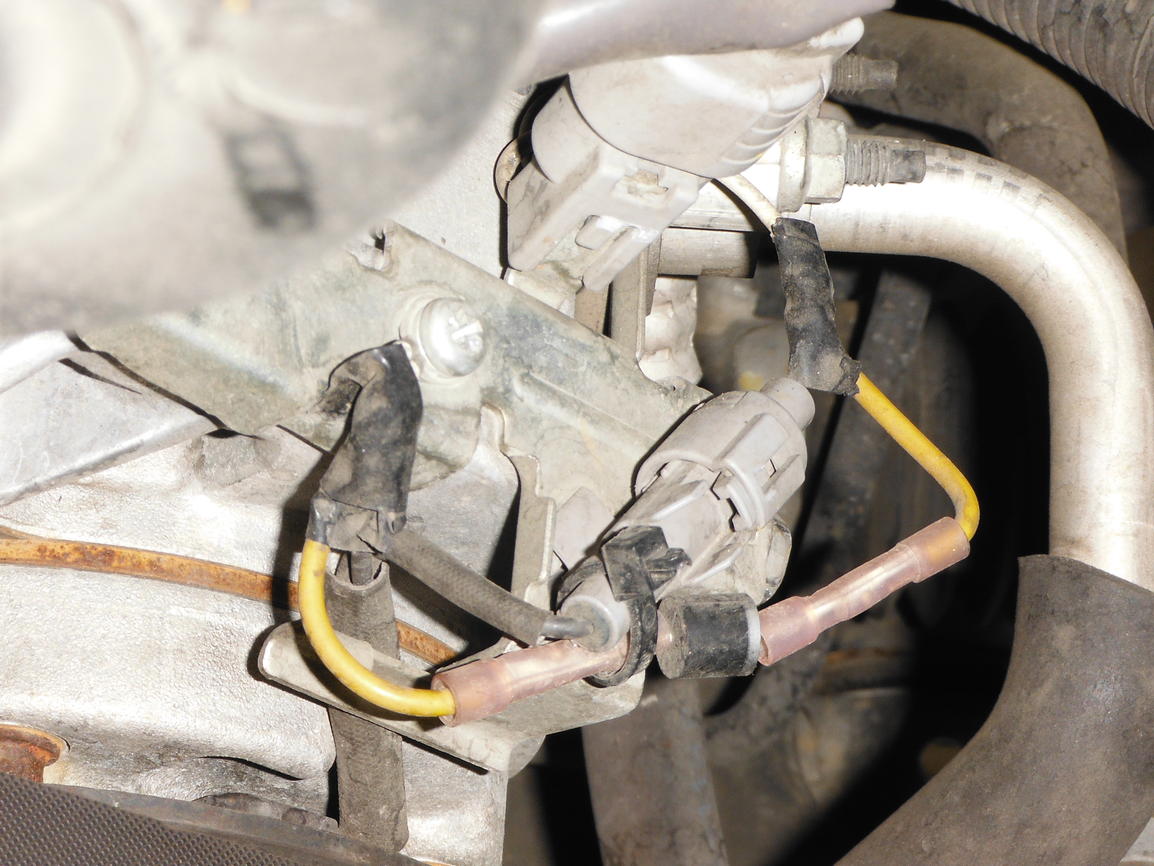

DaveT4R, Here is a photo of the installed diode. Thought I would post it here for the next forum member that needs it. I didn't do the install so I cannot give you any directions other than what the others have already stated above. ^^

Thank you so much! #coleb10
The pictures speak for them selfs, will be doing this tomorrow morning.
Should take care of the problem.
