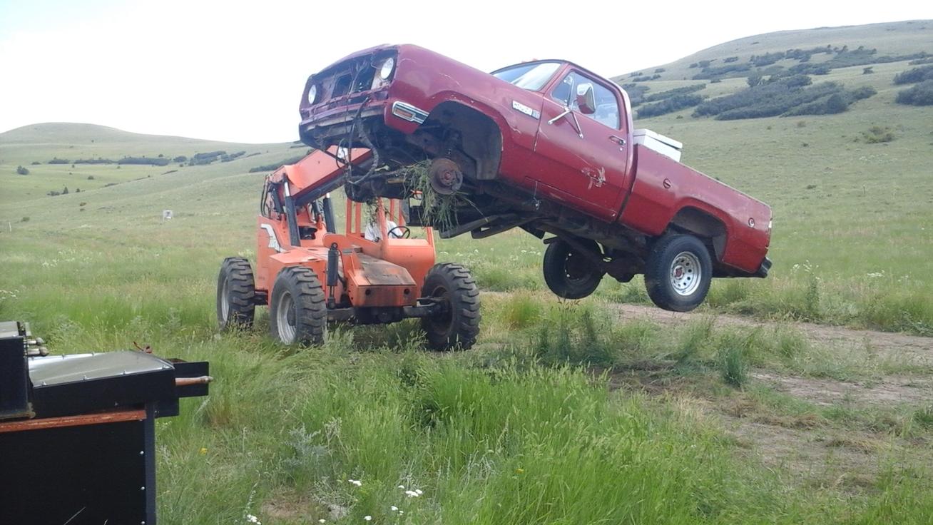

Absolutely....just drag/push it on the trailer with wheels on. If you want to do it without wheels...chain two logs to the lower A Arms and inside rear hubs to axle. cut ends of log at an angle for skids. Drag it right on and off a car trailer. If dragging on pavement lag bolt the chain to the side of the log in an X so you have four bolts.
