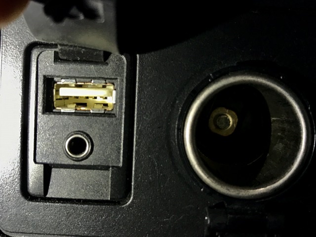

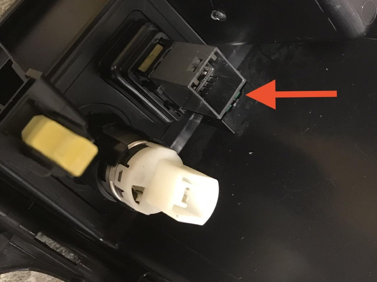

Do you have any clue what the wiring/connection is like behind the USB port? Is it literally a serial port, or some custom harness connection?
I’m not sure what your 2020 USB interface outlet looks like. But it’s probably similar to my 2018, a custom connector with the four-pin USB 2.0 port and an auxiliary audio jack implemented in a square plug. I can’t imagine Toyota would put in a USB 3.0 nine-pin interface for a run of a few inches.

I just wish/want to know if it's possible to deliver more power, given that I have to plug it in, to that port, to use android auto

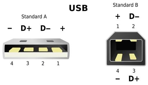

Personally no. The USB port has 4 pins. The two inner ones is for usb data and the two outer is for power. Since it’s connected directly to the head unit, your limited by the head units power output.
Your only option to gain more power is to use another external USB port but you’ll loose the ability to use data while charge at a higher rate because you’ll no longer have the data connection to your head unit.
But I wonder, is it possible to route the usb power pins to en external higher power usb source ? Of course disconnect it from the head unit usb power but retain the head unit data [emoji3]
