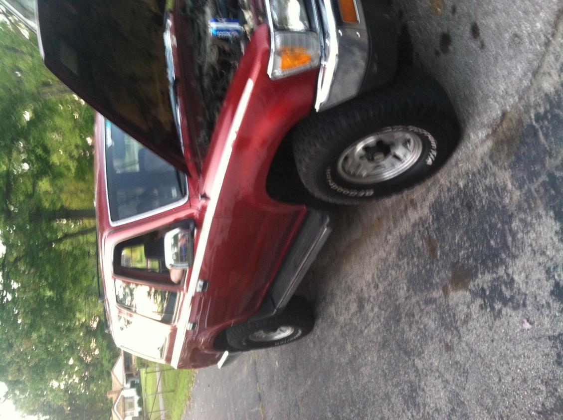

Here is my 2nd gen
3.0/5speed all stock
Just wanted to know wat gas milage I will be looking at and how bad it will be if I add a lift with 33s (on the 87)
