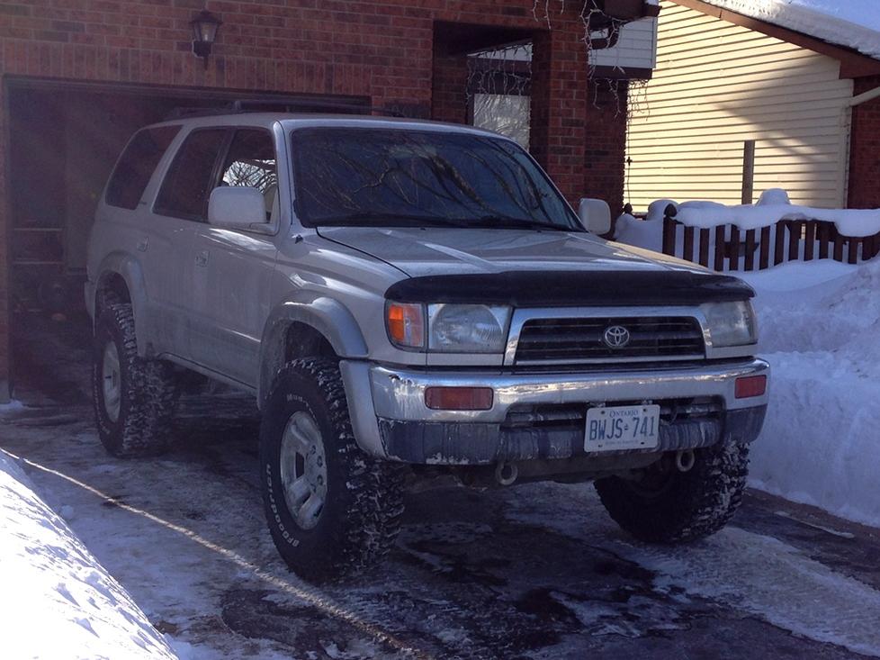

Just to give you an idea, my 4runner has roughly a 3" lift (OME Rear springs & Spacers up front) & 33" BFG M/T KM tires.
I can (barely) fit my 4runner in my garage which has a 7' clearence at the door. I have about 5" of clearence above the stock roof rack.
It should go without saying, but make sure to measure the lowest point on the rolled up garage door to the highest point on your truck. You might want to give some consideration to any additional hardware you may want on your rig. It will also be helpful to know your total end hight for future visits to various parking garages.
Here's a shot of it in front of my 7' high garage opening.

For reference, I have LC 8 wraps in the rear of my 4Runner. My total height, including the factory roof rack is about 6'4".
*ETA: I have the factory bump stops in the coils, so I guess that adds 3/4" vs. removing them.

I have a 3" lift and 33s as well and the first time I went into a parking garage that was 7'2 I got out to check, and had plenty of room. It doesn't look like you do driving up to it, but you will.
Remember most newer full size trucks are basically the same height as a lifted 4Runner on bigger tires OR bigger lol
But much uglier and with way less ground clearance.:thumb3:
As far as trucks go, 4Runner's have a very low roofline. Unless you have a tall roof rack, a 4Runner that is lifted 3" with another 1" in extra height from tires should fit in just about every parkade.
