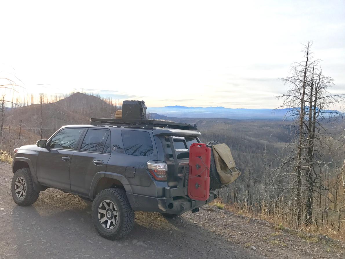

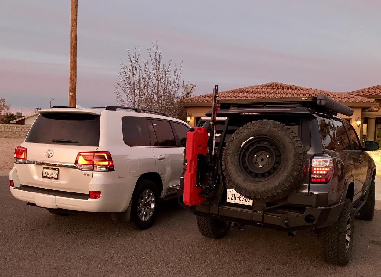

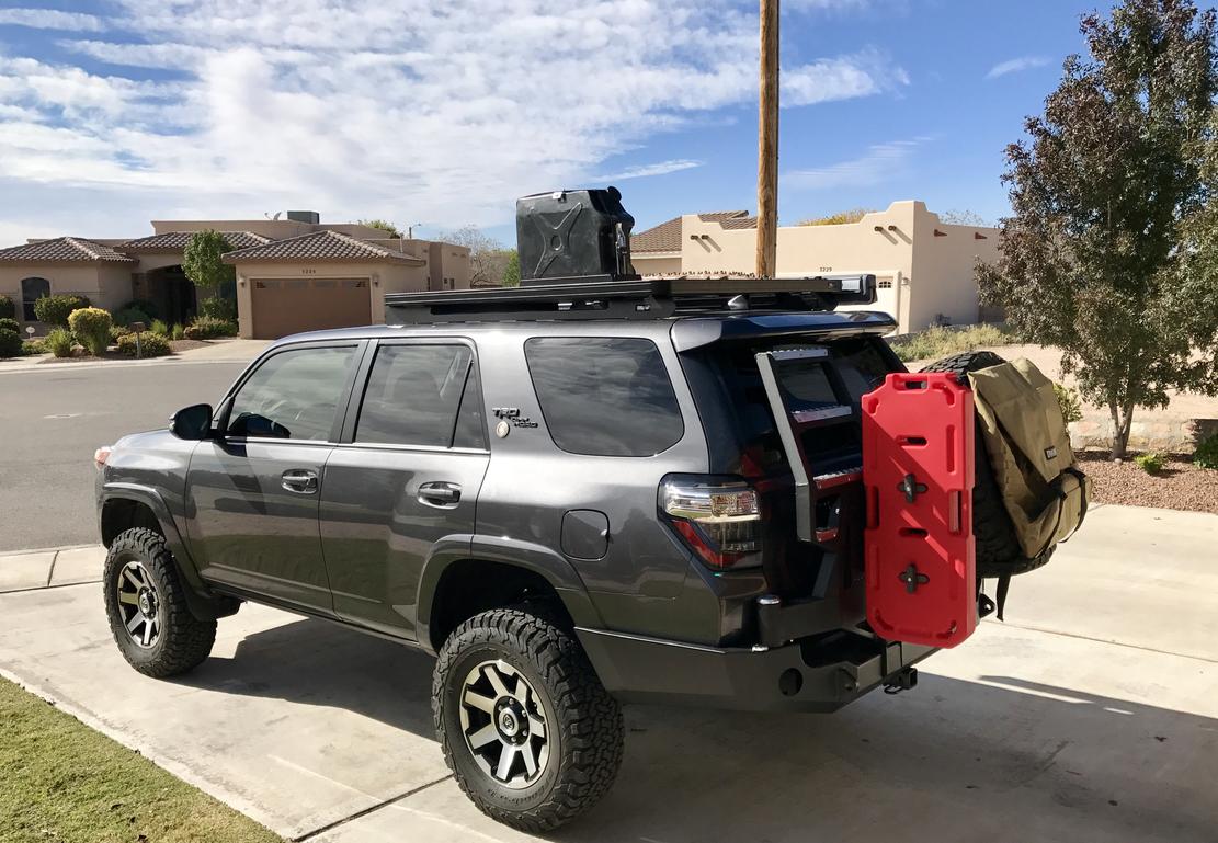

Can't go out and measure but here are some pics.
2017 TRD-ORP
OME "medium" springs in back
OME "light" sping/coil in front
Expedition-One rear dual swing arm bumper
SSO slimline w/ smitty X20 winch up front
Frontrunner 3/4 rack on top
SSO sliders
-Chris

Man that's tall. How's the ride with the 898s... loaded vs empty?
Honestly, most of my weight comes from the sliders/bumpers. I do notice the weight up front as I'm running the light duty springs, but all in all I have ZERO regrets. I really don't think it's that tall, perhaps it's the angle of my pictures. The lift is advertised as 3 inches, but with the added weight I doubt it's still sitting at 3.
-Chris
