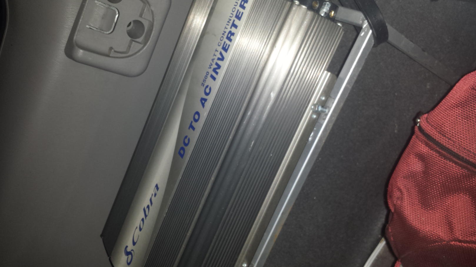

I have a 2500 watt power inverter installed in the back of my 4runner behind the rear seat. I was just wondering if I keep my car running while I use it and don't max it out (I've never used over half of its potential power, even with an electric griddle) will I run the risk of doing damage to my alternator? also have a normal sized battery in it still will it do anything else other than just run the battery out?

Not sure what you mean by voltage drop. The guy at Auto Acoustics that installed it finally responded and said I shouldn't have to worry about anything because they used a heavy gauge wire and 2 fuses For both of the power wires they installed he told me "as long as the car is running it should be okay" Still skeptical but I haven't had any problems yet so I guess I should be okay.
I was only wondering because I'm going camping soon and will be using the inverter a lot.
