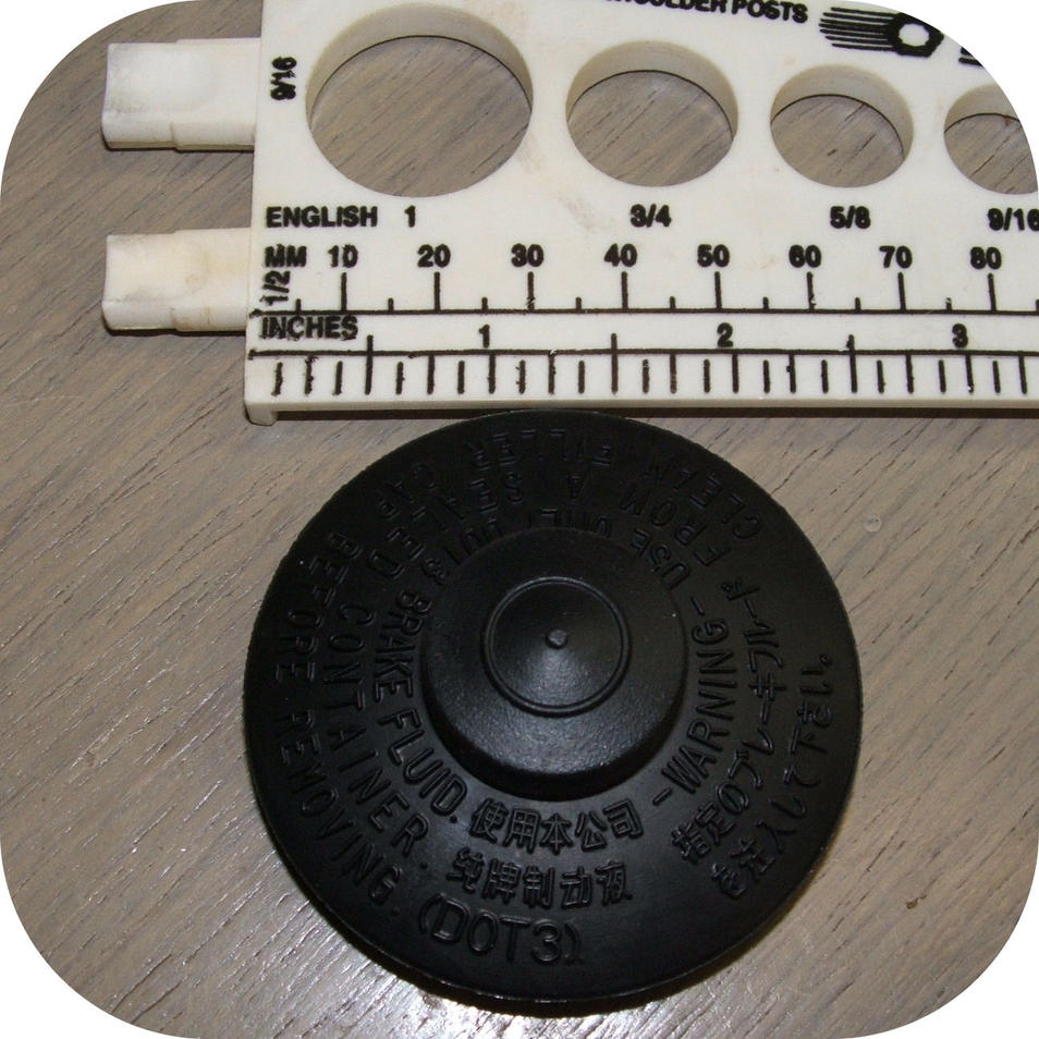

The oil fill cap says "use only dot-3 brake fluid" WITH a warning.
