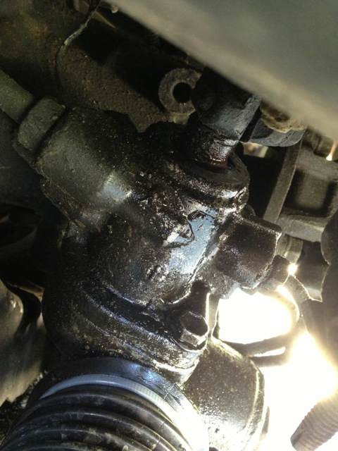

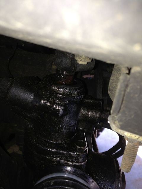

Here is a picture of mine
Only leak on the whole dang truck!!
Mine doesn't look that bad. How much fluid do you go through?
Also, it seems you are missing the rubber dust boot that should go over the seal..
