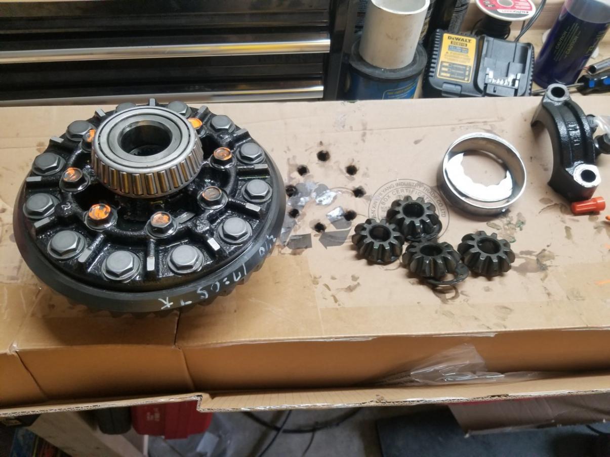

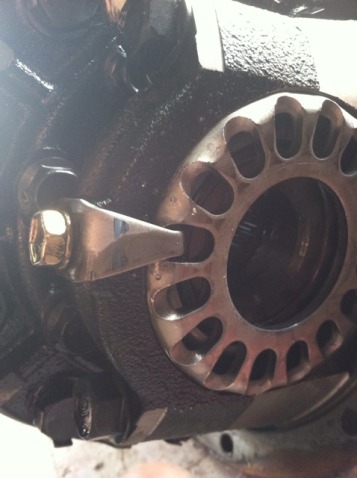

The major difference is the 3rd gen uses these adjuster rings:
5th gens do not. We have shims in ours (non e-lockers). We had to use a dead-blow to tap them out. I did not take a great picture of these, but you can see it sitting under the bearing sleeve on the right side of this picture.
Outside of that minor detail, we followed that write-up.

The 8.2 and 8.0 carrier flanges are definitely not the same. For starters the 8.2 has 12 bolts for the ring gear where the 8 only has 10. But it appears that the internals may be interchangeable. Sounds like the internal carrier that bolts to the flange is the same. That's good to know! There are a bunch of "lunch-box" lockers for the 8" diff that could be used.
Now I'm going to have to measure the ring gear internal diameter to see that they are in fact the same ID. I have some of both in my garage. If so - and the offset is the same - and rear locker for the 8" should be machinable to be used in an 8.2 by changing to the bolt pattern or having a machined flange build to match.
Also the 8.2 e-locker uses adjustment rings. I assumed the 8.2 non-elocker used them also. That is also interesting to learn that they're shimmed in one and not the other.

Right. I think ECGS meant more the internals are the same. My buddy who helped me with this was also surprised by the shims.
When I talked to ECGS they listed a list of lunch-box lockers that would fit. Unfortunately I didn't write any of them down, but of them, I remember the powertrax (obviously) and the spartan locker.
Updating OP so as to not confuse people.
