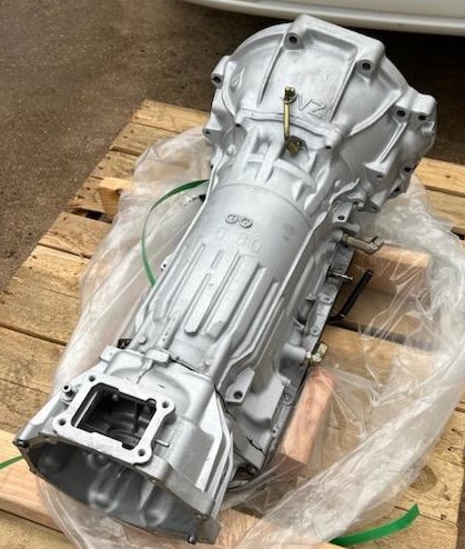

I went with a new Yota1 trans for my '01. Old trans developed the highway speed whine, then shortly after the occasional marbles/rattles then silent again, then locked up/shut engine down twice on the way to its final resting place before the new trans.
Old one did set a P0770 twice about 5 years ago, reset and never again. I did use OD override often when going up hills especially when towing, not sure if that contributed to the known weak OD in the 01-02 units as I've heard yet the original trans did last 340k, though I think I could have been more diligent about drain/fills over the years, I think I went too long a couple times, like 100k, won't do that again. I bought it with 175K and doubt it was changed during that time.
It did take about 7 weeks for Yota1 to build/shipout (they told me that upfront) yet it was/is worth the wait.
New trans is flawless, had one hard 1-2 shift early on, probably due to fluid not filling every space just yet, never did it again and have put about 4K on since last fall. It does ship empty so have your fluid ready.
I installed a haydon 699 (doesn't flow until 185) and along with a new radiator/185 thermostat using its internal trans cooler maintain new trans no higher than 190 on climbs/stop-go/towing (only 1800lbs), more usually around 165.
Old one must have had some slip thought I couldn't feel it, because new one gets almost 2 mpg more, nice bonus. And yeah it is pretty to look at compared to my old one, lol.
Only caution I can suggest is to ensure yours does/does not have the cover plate like mine, see pic of new one. Even though Yota1 had my VIN, they built it without the plate assuming my old one had the plate to move over, it did not, old one has no plate/cover over that area, Yota1 sent one promptly yet it could set you back a few days so ask ahead.
