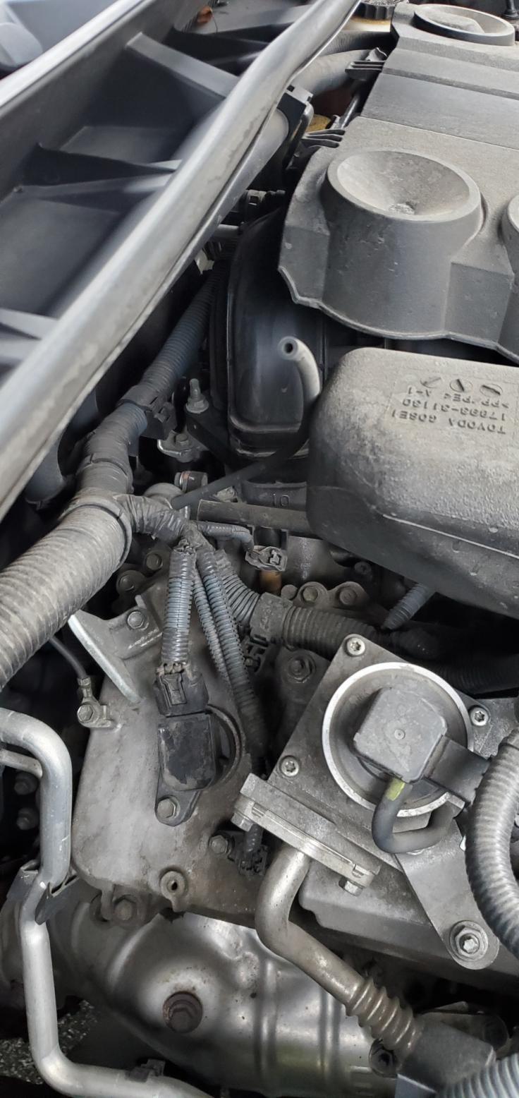

Wow! I just checked mine as well and was very surprised to see it was not connected! I had it at the dealership to get some maintenance done so it might've happened there?!? Mine is a 2015 and have no idea how long it has been disconnected. It seems to drive normally and when I picked it up at the dealership they told me it was in 'magnificent' condition. I'll keep an eye on it but not going to worry too much.
I went to dealer last week and argued with them about how the host was disconnected. They claim that the host shouldn't be disconnected for that long as if it was, they said the check engine light will be on. They said it might be caused by mouse creeping into the engine bay, as they showed me seems some footprints of mouse but it hard to say. Technician checked the oil and smell the oil and say they don't think there is fuel into the oil and everything seemed normal, no damage. It was very hard to argue with them.
I ended up doing oil change just to be safe.
This is a load of crap. I went out to my 2018 just to see if the hose was connected and it was. Pulled on it with a bit of force to see if it would disconnect and it wouldn't. There's no way a mouse could pull that out.
Next they'll tell you that the working soft serve ice cream machine at McDonalds 500 miles away caused your sunroof to leak.
Wow, apparently dealers cannot be bothered to reconnect that important hose.
