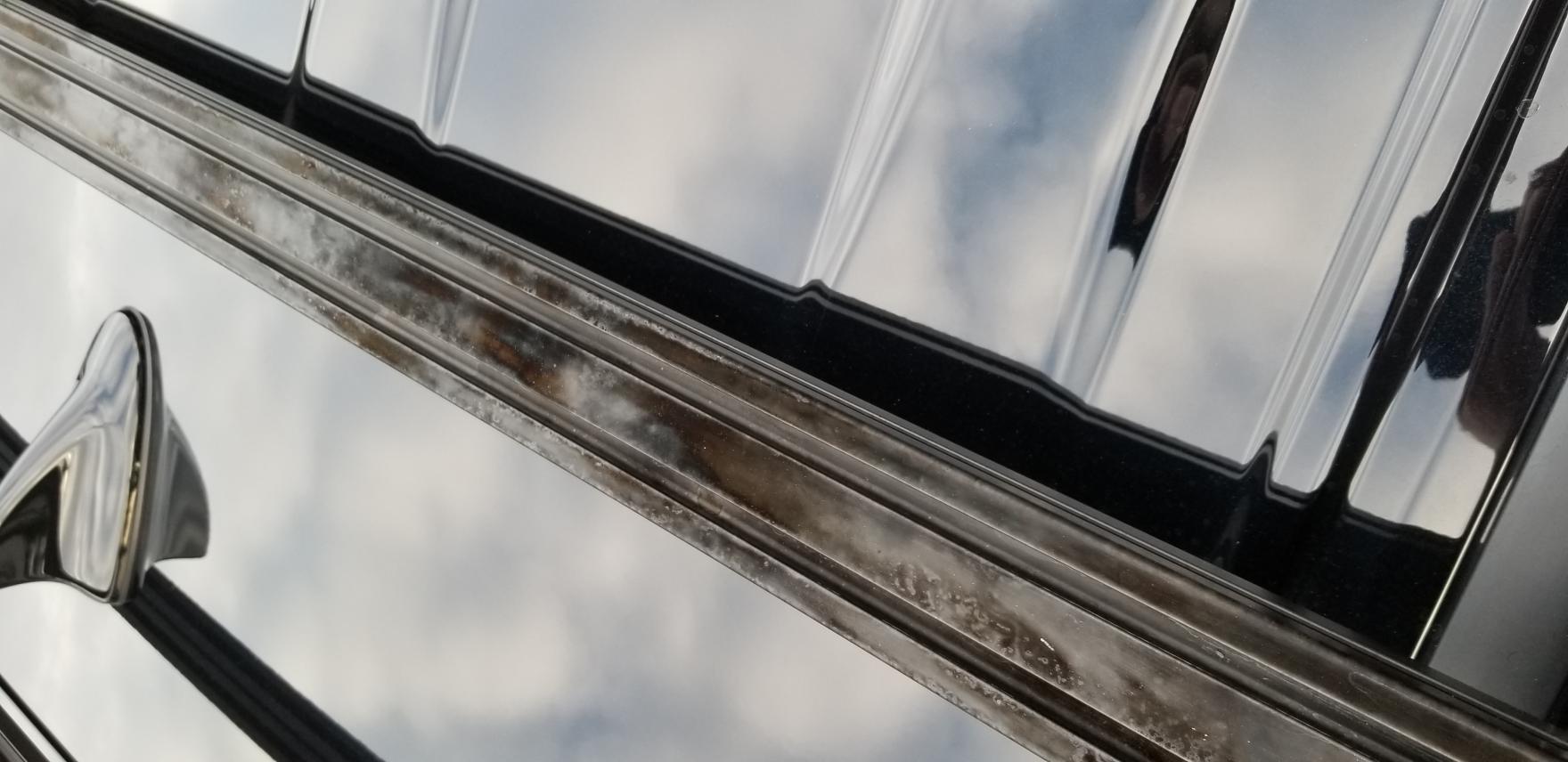

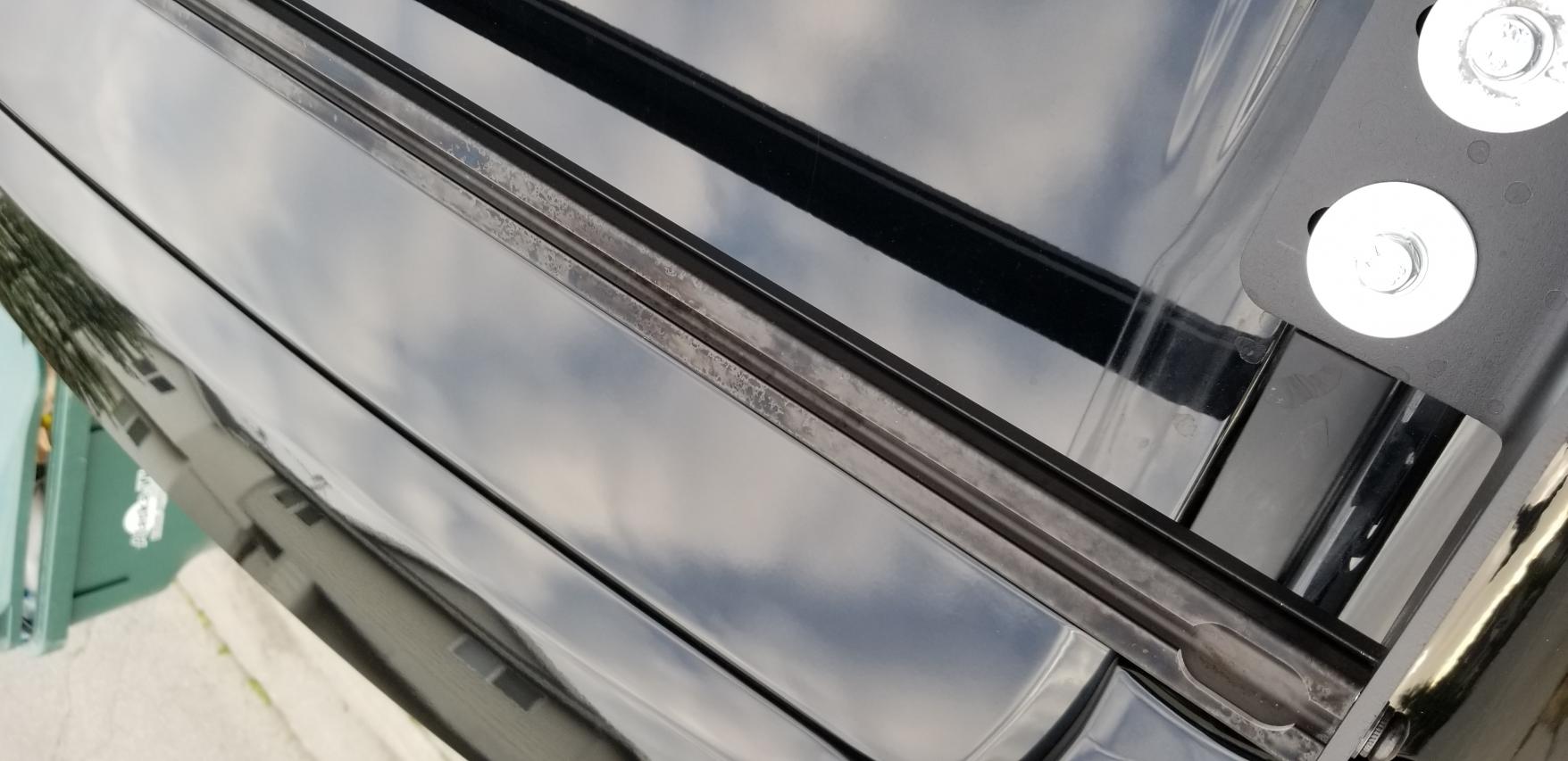

Prinsu roof rack and touchless car wash. Crossbar discolored.
So I got a dab of wd40 on a rag and wiped the rails. It got nice and shiny and looked better. Not sure what it will look like when it washes off or the next time I go through the car wash.
Mine look like that and the paint on my roof could use some love as well since it isn't all that easy to access for a proper cleaning with all of the crossbars in the way. I wouldn't worry about the staining on the bars, with exposure to the elements all of that stuff will look like crap in short order.

Yea it looks bad, I was pissed when I first got it. Now its been almost a few years I don't care anymore lol.
Its not the car wash, per se, but instead it is the cheap anodizing on the cross bars. Anodizing creates a very thin layer of porous aluminum oxide which is then dyed using various colors which absorb into the pores and are "sealed" using various methods. Cheap anodizing uses poor quality dye and sealer which results in the color bleeding back out of the parts, especially when soaps and detergents are used. That's why the WD-40 makes them look better temporarily. It fills in the pores until it is washed away again. There is nothing you can do about it except have the bars re-coated somehow. I recommend having them powdercoated at a reputable shop using a UV-rated powder. Cheap powder that is not UV-rated will end up doing essentially the same thing over a short period of time. Line-X or bedliner would also be good options.
Thanks for the info. I'll wait til they are all beat up them have them coated. We have Hydro Dipping place as well. Its mainly used on guns and scratch resistant but not sure how it holds up to UV like you said.

You can use a brush carwash with gentle chemicals but the brushes scratch the paint, a brushless carwash with harsh chemicals but no scratches, or do it yourself.
This kind of seems like an issue with the racks finish since the rest of the vehicle seems fine.
Paint & anodize aren't the same, and react differently to chemicals.
This was my thought. These bars should be able to take more abuse then my paint.
Anodizing can actually handle less abuse than automotive paint. Since most of this material is used indoors they aren't going to be very UV stable.

This is just what happens to anodized aluminum bars that are exposed to sun and weather on the roof of your truck. The bars on my SSO look the same, as well as the additional bars I ordered from tnutz.com
I may have just missed it, but how old were these bars when they began to discolor? Have they worsened significantly?
This was a brand new roof rack. I only had it a few weeks before I ran it through a Laser Wash. They're about 18mo old now and still same issue.
