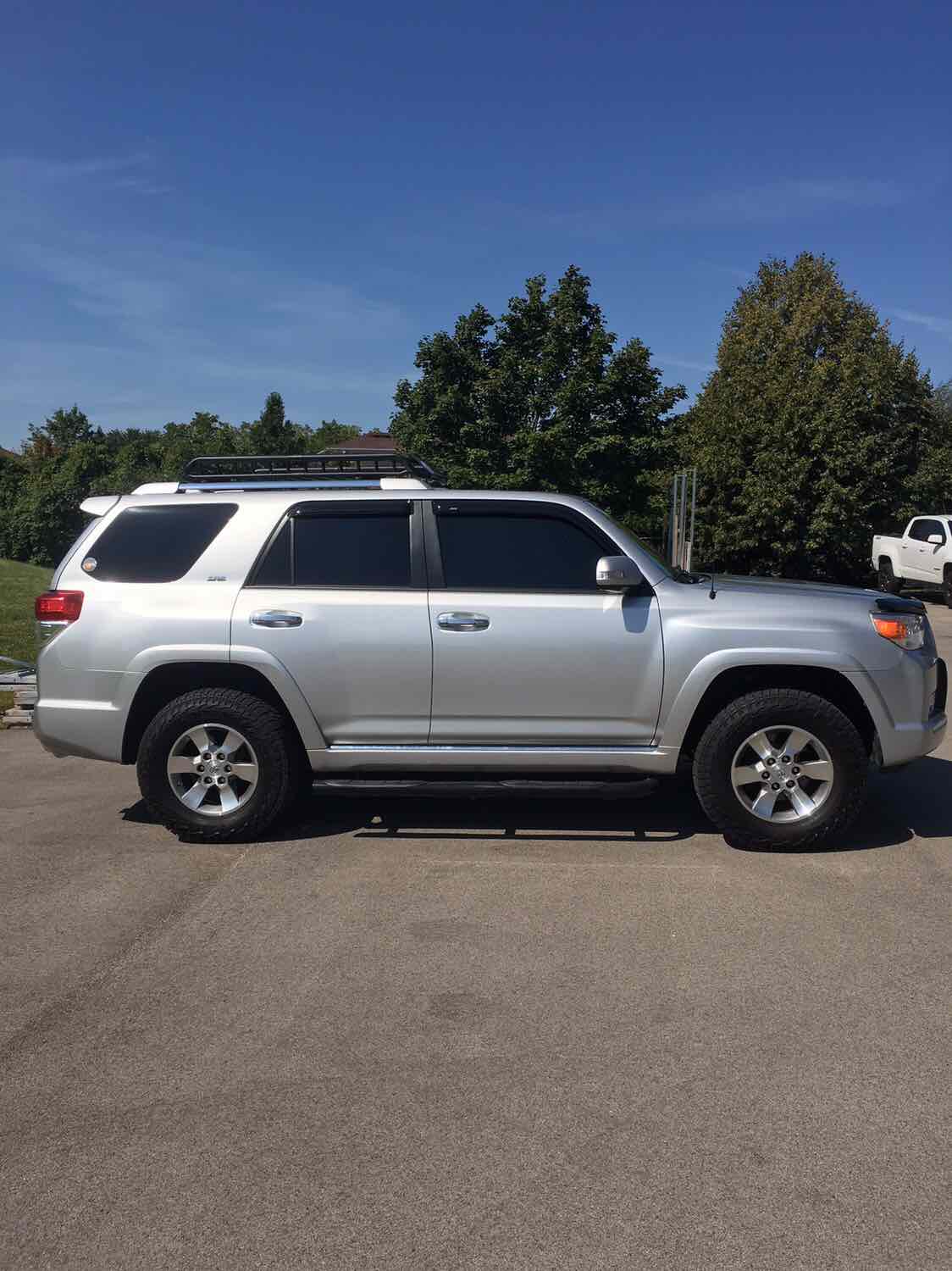

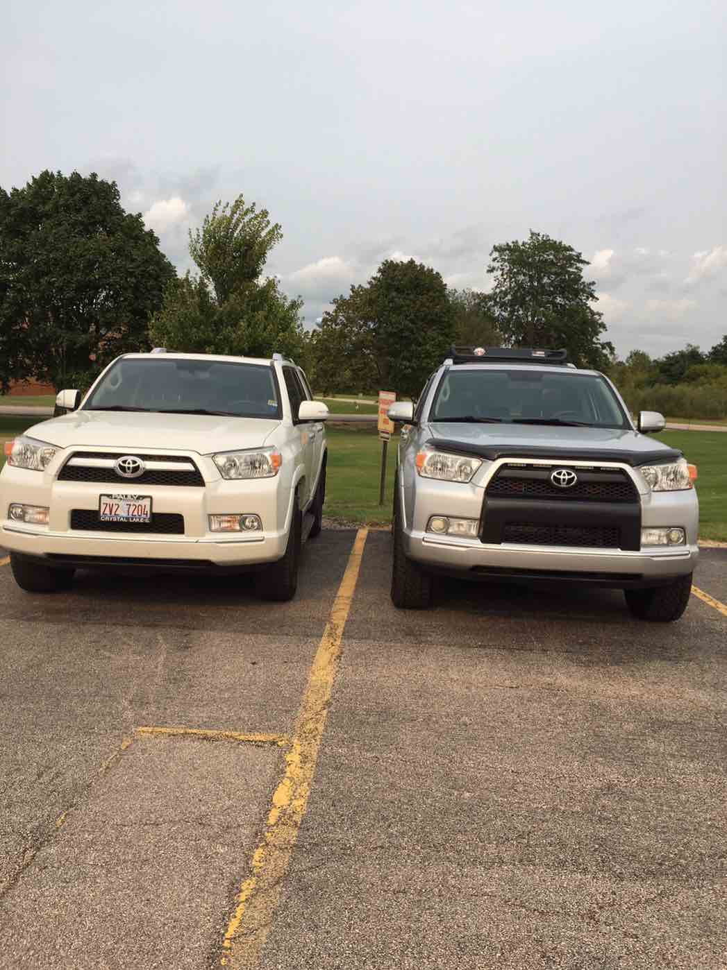

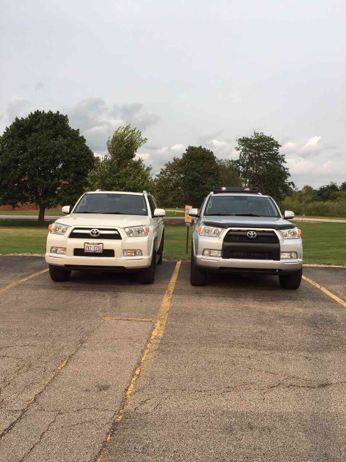

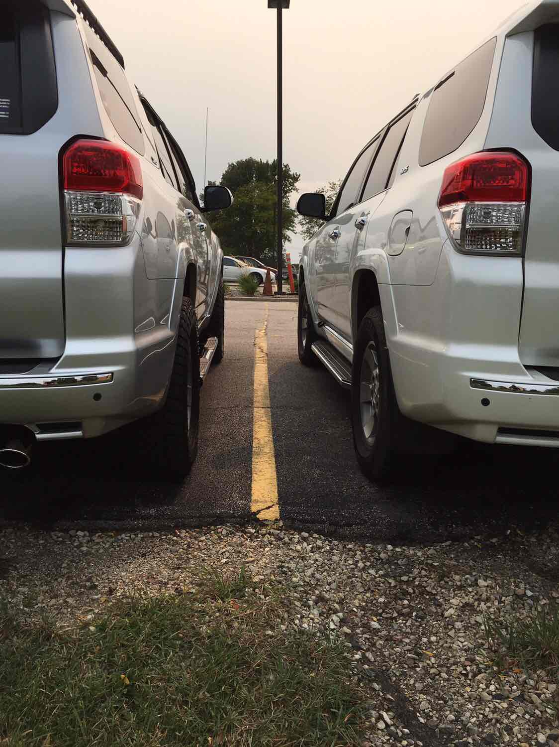

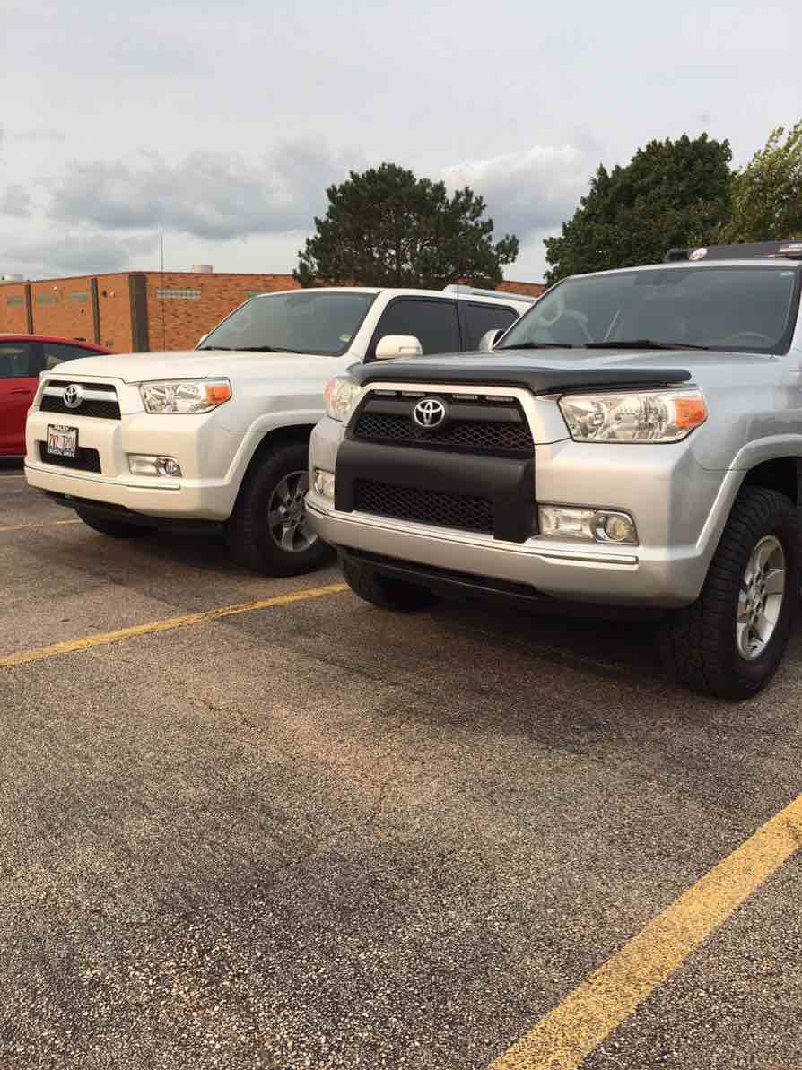

Go with the Bilstein 5100s. You won’t regret it. There’s a reason they’re super popular here and elsewhere. Set the front to .85 and you WILL get lift for extra ground clearance in the front. It is correct that the rear stays the same. Below are some pictures of mine set to .85 compared to a stock runner. I’m running stock size tires so this is basically an apples to apples comparison.
I replaced my setup because I had a leaking rear shock and I couldn’t be happier. The ride over stock has greatly improved and my off roading experience has been awesome. I think you’ll achieve what you want for a great price. Besides, if you do the spacers you’ll always wish you had done your suspension. If you do the Bilsteins, I highly doubt you’ll look back and wish it was the other way around. You get great everyday comfort and off roading abilities that most people are just fine with...myself included. IMG_3878.JPGIMG_3879.JPGIMG_3880.JPGIMG_3882.JPGIMG_3872.JPG
The last pic is a side shot with my nerf bars still on. Gives you a chance to see the nearly level with a minor front take look.
Thanks for the pics. That looks GREAT, night and day! exactly what I am looking for . However, I do have a question on your setup. DO you have wheel spacers as well? Or are those rims a different offset? Because the stock 2017 Sr5 wheels are tucked in so far it looks kind of funny to me. So that's something else I am looking at.
