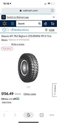

PSA Maxxis Bighorn 255 85 on sale for $156 today
https://www.walmart.com/ip/Maxxis-MT-762-Bighorn-255-85R16-119-N-Tire/615505727
I picked up 5 of them shipped for $851 ($100 cheaper than the next cheapest site)
The longer story - I’ve been shopping for the last week comparing prices on 255 85 tires and I swear to god the cheapest I saw this tire was $178. Even as of yesterday Walmart did not have them this cheap.
Then tonight I found it at Walmart.com through a google shopping ad for only for $156.
If you go through their normal site it’s $210 per tire, so this is quite a bit cheaper.
If you’re in the market pull the trigger!

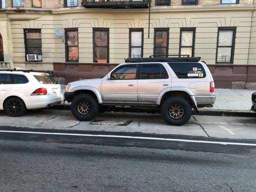

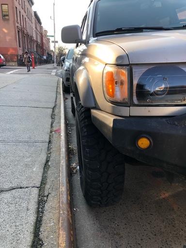

Got them in yesterday and mounted today. They look great on my new VTX Rogue 16”s
Because of the offset of the wheels and the 8” rim the tires don’t look too skinny at all and are flush with the limited flares. I love it.
The 16”s have 4.00 backspacing and just barely clear the tundra 199mm brakes.

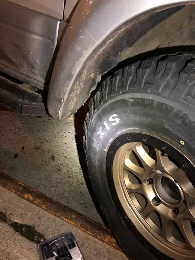

I’m getting a little bit of rub while turning, I had to get to the office but I’ll take a look tonight and see if I need to hammer my pinch weld and maybe the rear inside of the flares.
Then to a real alignment shop to see if they can set my caster to get the tires more forward. (firestone here in Brooklyn is braindead, so my lifetime alignment there is a waste)

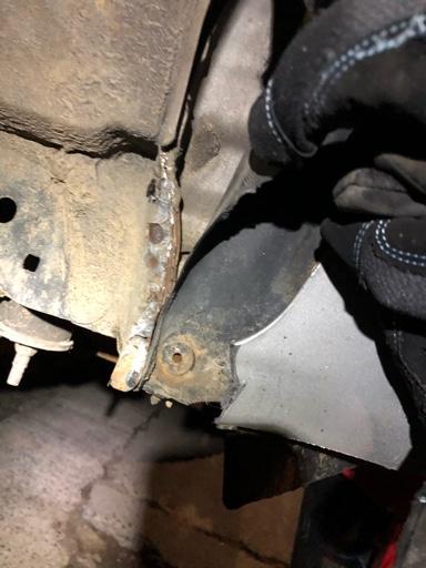

Remove the bottommost screws from the flares and hammered the pinch weld flat. Also cut the fender liner and the bottom inside of the flare a bit
Fingers crossed I think that might have done it. I know IFS doesn’t have much travel up front, so I cranked the wheel to the right and drove up the curb for some baby flex. It didn’t rub!
