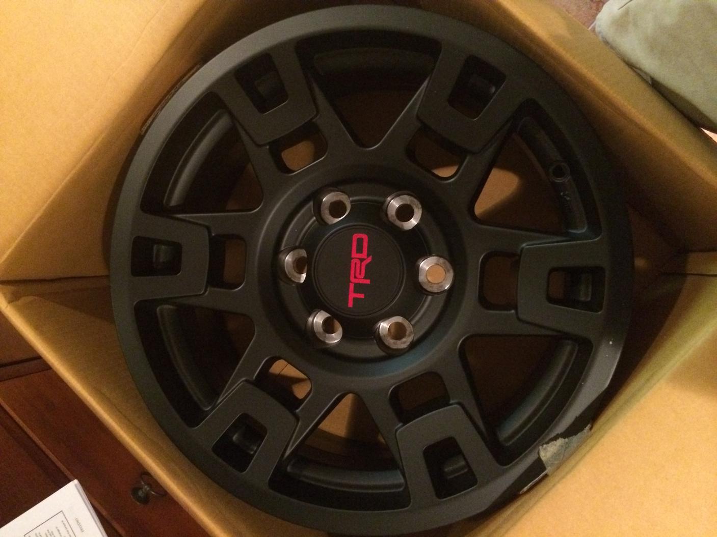

I have an '09 Trail and I'm wondering if the PTR20-35110-BK will fit. I've searched a lot and keep finding conflicting info. I haven't seen any pictures of them on a 4th gen, but I have seen them on a 3rd and 5th. I'm a mouse click away from buying these, and I want to make sure I'm not making a mistake.
Thanks!
If you can find out the lug size/pattern and offset you should be able to cross reference pretty easily. Any idea what they are?
If not, call the seller and get that information and we'll be able to tell you if they will fit or not.
Thanks for the reply. It looks like the lug pattern is the same (6x139.7), the offset is 4mm. One site claimed that they were 11mm. The wheels are 17x7 inches. Any help?
They are narrower than stock wheels (all 4th gen rims are 7.5" wide) so as long as the off-set isn't too far inward (or would that be outward? I always forget) it should be fine as it fits on the Tacomas and FJs.
The bolt pattern is the same 6-lug Pattern Toyota has used for a century now (feels like it lol) Its a newer TRD Wheel offered for J150 vehicles so it should fit okay.
Thanks guys! It looks like they should work. I'd love to find some pics on a 4th gen, I've searched everywhere. I think they'll look great with the shadow mica paint. I'll place the order tomorrow.
Now I get to figure out tire size...:eyebrows:
They fit fine, I have them in Gun Metal on my 06 Sport
So I got them. I'm currently looking for tires and about to order the DS 2.5/1.5 lift. BRossman, how does that offset look on yours? I'm considering getting Spidertraxx spacers, but I'm wondering how they will look with these wheels. Also, what brand/size tires did you go with?
