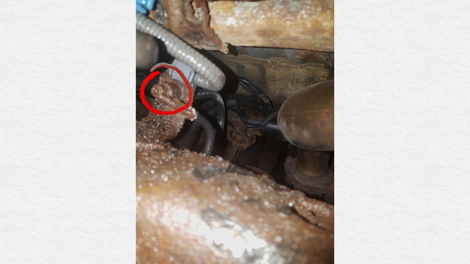

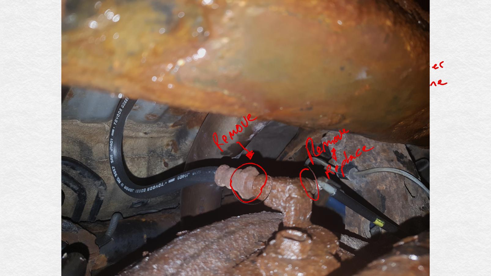

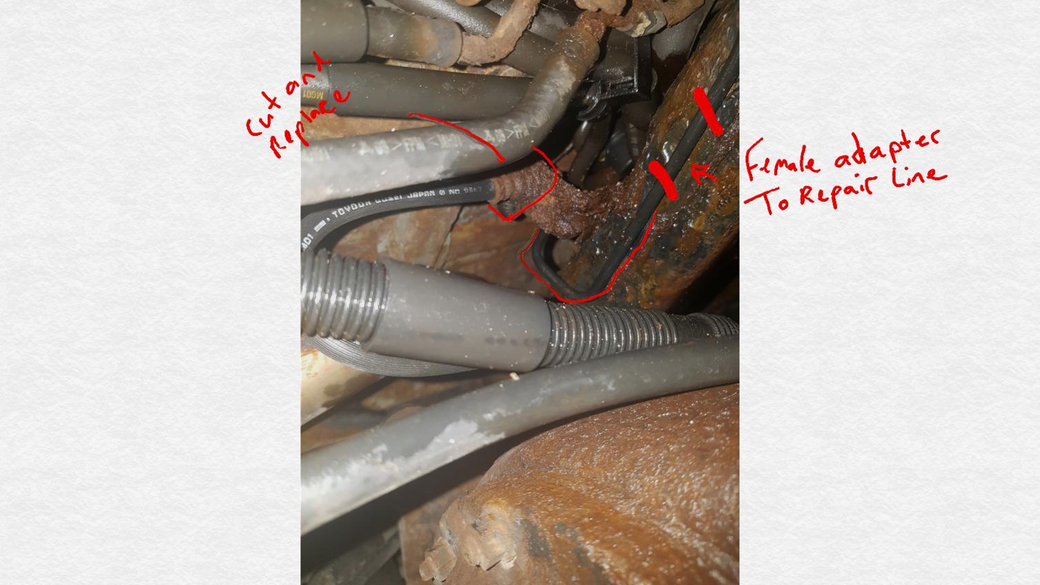

Ok so i have any issue brake line broke today...........but in the worst spot on top of the frame right by the pumpkin. Now here is my issue the bracket is to weak from rust to just get it off. ive held it with small pylers but zero space to get a good grip. So this is the idea cut the rubber line replace it with a new one and fit a new brake line into it as as well as a female adaptor to avoid replacing the whole line.
i've attached photos and some descriptions of the plan but if someone has a better idea im open to it.

Get a wire brush and clean that area up!! Then use the proper wrenches and sockets to take off and replace the bad parts. You don't need to mess around with your brakes!!!
so everything has been completed i basically did what i showed but jesus that flare nut was a ***** to get off ... and get a new one on because of that spot
