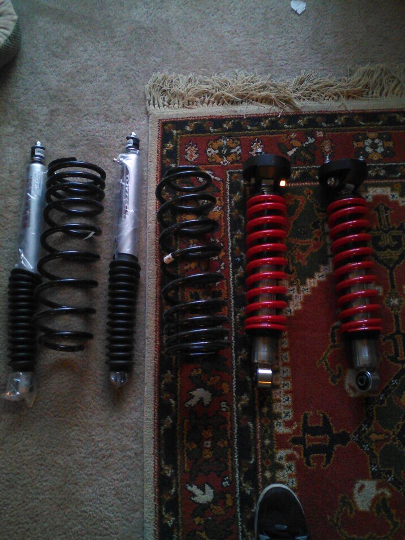

I have these sitting in my house awaiting install

You lucky dog. I am SOOO jealous. I've got a Daystar spacer lift front and rear. It's all I could afford with the new shocks all the way around. I can only dream of the set up you are going to install.

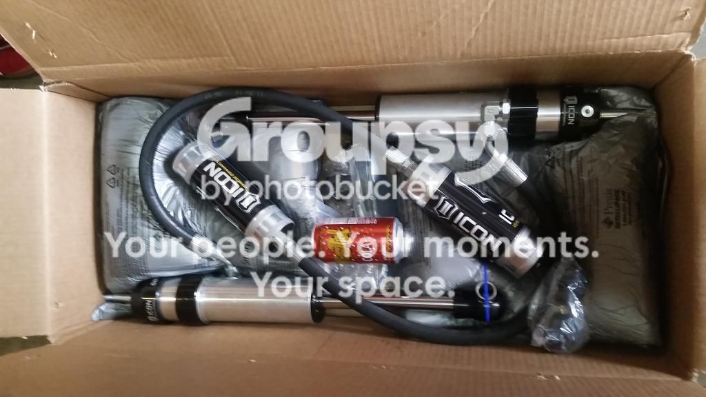

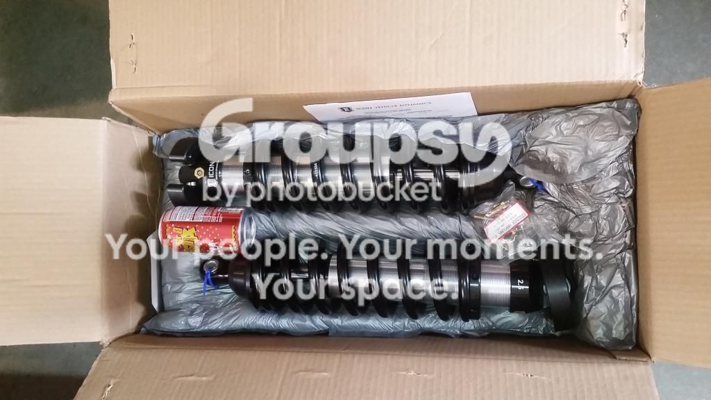

Man after all you spent had to settle for the fiesta...
Im just playing, your gonna have a sweet setup. Ive been looking at that same one. If you ever go wheeling on the east side shoot me a pm and i could meet up.

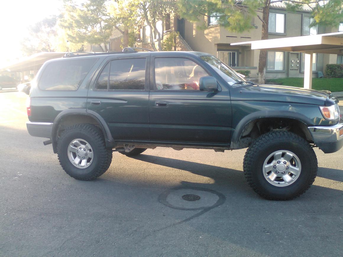

Put the 3in Toyotec BOSS lift in. And couldn't be happier.
