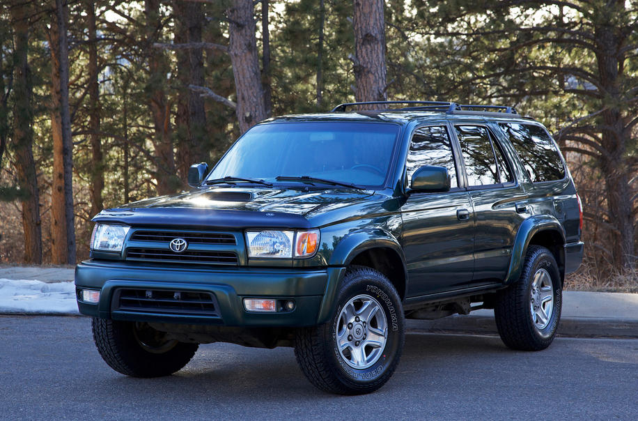

I think I have made a decision! I have decided to go with the manual 4runner without the locker. I drove the automatic, and I felt that it did not have enough power, and I felt that I did not like the four-speed. Therefore, I've decided to get the manual 4runner and retrofit an e-locker onto it this summer.
Ask and you shall receive!
I am taking it in this Saturday for a 150,000 service, and NEXT Saturday is the E-LOCKER RETROFIT. Very exciting. Let me know what you think!
So far I've put new tires on it, and taken off the running boards.
