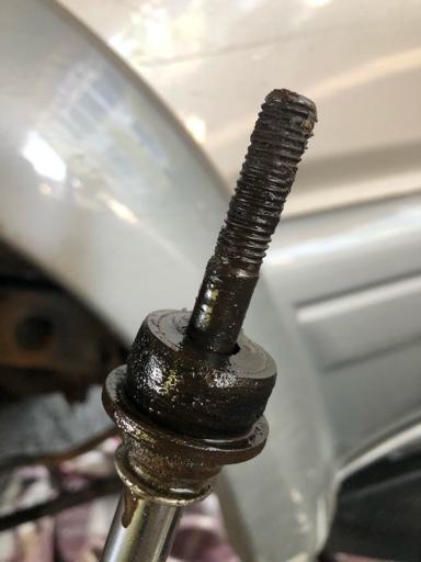

So I figured this time I’d do it myself, I didn’t care what it took. We all know there’s hardly any room to work up there, but really the biggest problem with changing 5100’s is that it’s really hard to keep the shaft from spinning. There is an Allen key spot at the top but that quickly stripped out.

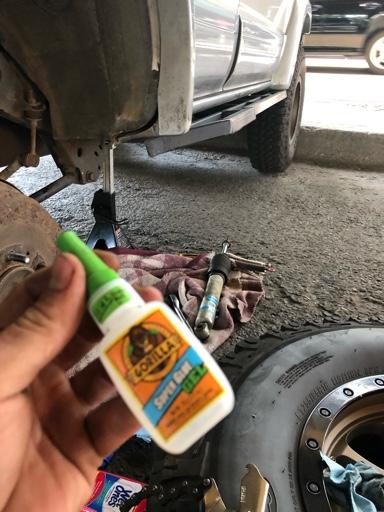

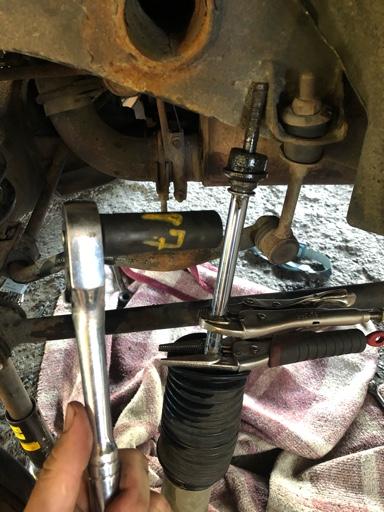

What finally did end up working for me was using 2 sets of vise grips + gorilla glue super glue gel to grip the shaft (stop laughing).
I also used some channel locks to turn the screw at the end of the vise grip handles to continue to tighten them to a ridiculous level of tightness. For the other shock instead of super glue I used silicon tape, that worked also, really anything to help the vise grips grip the metal.
For the bolt on top of the shock I used a ratchet + extended length 6pt 17mm socket to turn the nut at the top of the shock (+plenty of pblaster). However, for the most part I used the vise grips to turn the shaft to loosen it while holding the nut steady with the socket on top.
After doing all of that I was able to get the shocks out and they’re still in good shape to be resold.

Them shocks were trash right about the time you clipped the vice grips on the shaft.
You can’t have any nicks, dings, or scratches in that chrome shaft. It will trash the seals in the shock in short order.

You’re probably right, I thought about potential damage to the shafts, I’ll check em out tomorrow. The shafts are pretty hard so maybe they held up, I didn’t bother to check them out too closely when I was done since it was late.

Any imperfection on the shaft will tear the rubber seal any time the shaft goes into the tube body during compression

this just happened to me too last month. i thought it was a clever idea but moisture accumulates inside the allen wrench slot and slowly corrodes it. the front design is better which the sides are flat. just clamp it.
Fill with grease and put a rubber vacuum cap on it
