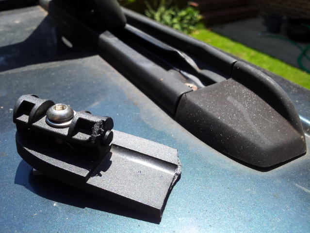

I had Annabelle outfitted with Yakima towers and 72in crossbars, *Sniffle* …She was beautiful. A strong wind on the interstate caught the canoes and ripped the rail-rider towers out of my OEM tracks (I had the bow and stern tied to the bars instead of the tow hooks- lesson learned).
Yakima is replacing their equipment and being very helpful, but I have to decide whether to replace the mangled tracks with Toyota tracks or with their Yakima replacement tracks. A Toyota replacement would be simpler to install, but I would love to have longer tracks to set my crossbars further apart for longer boats. Does anyone have experience installing longer tracks over the predrilled holes? Could they run up past the sunroof? I have no experience with body work and will probably try to find a good shop around NE Atlanta (likely on Yakima’s dime).
Any experience or advice would be great.

I got a reply from RackAttack.com:
"I wouldn't recommend removing your damaged factory tracks and trying to replace them with Yakima tracks. The bolt locations will be different and potentially lead to a leaky roof. If you want the Yakima tracks I'd determine a location on clean sheet metal and redrill the roof according to the mounting holes of the Yakima tracks. Make sure that the bolts lie outside the perimeter of the sunroof, even when opened; and you'll be just fine. If you want to keep the tracks in the factory location, definitely go with Toyota tracks."

I got these because I didn't have factory racks. The holes don't line up but I took the covers - in your case you can take the old racks - and mark the new tracks with the old holes and drill the tracks out. Then just screw into the existing mounting holes.
Works like a charm.

Yakima sent me some free replacement tracks along with a 78in crossbar set up with freight/cam straps ( 78" = just wide enough for two canoes). I went with the longer 60in tracks, so I had a shop drill the extra holes and install them last weekend. I'll play with the new rack tomorrow!
