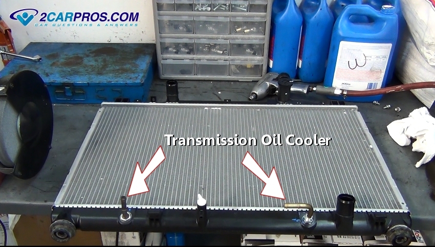

Look at the bottom of the radiator in your manual rig. If you have lines going in, one on each side, you're good. Otherwise, you're looking for a new one. You have to have a cooler for the A340 transmission.

There may be a chance the radiator in the manual has the integrated cooler if it's not the original (seen people use auto radiators as replacements in manuals when the former wasn't available.). If not, you can still use the radiator but will need to go with a separate trans cooler. Depends on what you want to do, price of the each, etc.

.....just posting this pic as a follow up to help show what those connections commonly look like:
