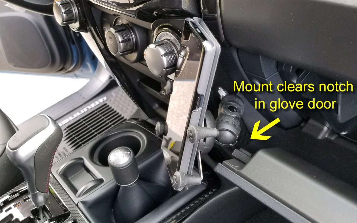

So this writeup did give me the idea that I could probably do the same thing but situate the mount over by the glove like in my '06Sport with the Proclip mount. Ichecked the location with the RamMOunt and noticed there was room and actually the glove door on my new TRD Pro is notched right there which allows the glove to open and clear the arm on the Ram Mount. Also all button/knobs are still easily accessible and the setup doesn't get in the way of a passenger sitting in the front seat.

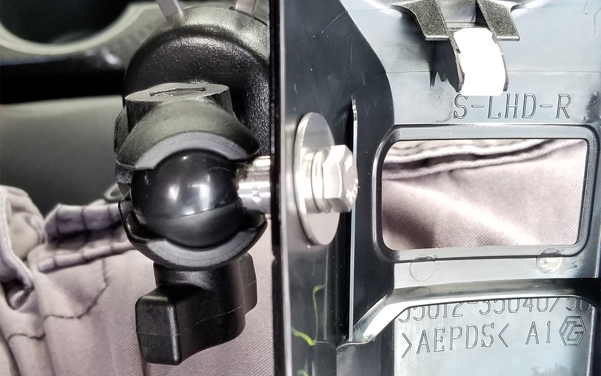

Here is pictures of what I did (note that I used the exact same Ram Mount and mounting bracket parts detailed in the links above so I won't repeat them)....

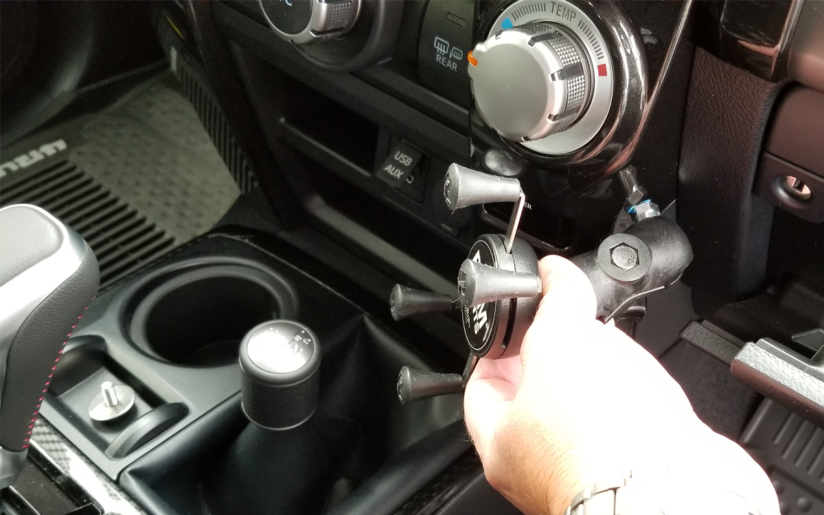

First I lined everything up where I wanted it and made sure it didn't interfere with the glove door. I market the location with a piece of painter's tape.

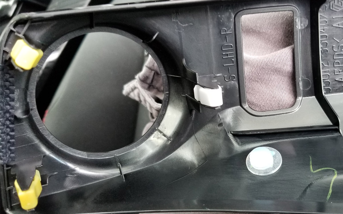

Next I got a little furniture foot glide sticky thing and put it on the inside of the drill location to approximate the size of the head of the bolt and washers to check that it cleared the console frame parts when I put the trim piece back on.
After lining everything up and confirming the fit, I drilledsmall pilot and then enlarged to fit the bolt just like in the video. Again CAREFULLY and SLOWLY because it's just soft plastic.

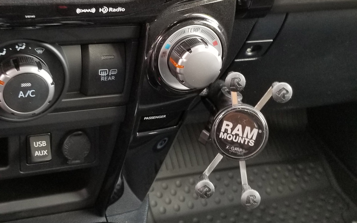

Then just simply bolt in the mount through the trim piece (I used a lock washer in mine in addition to the same washer they used in the video) and put it back together.

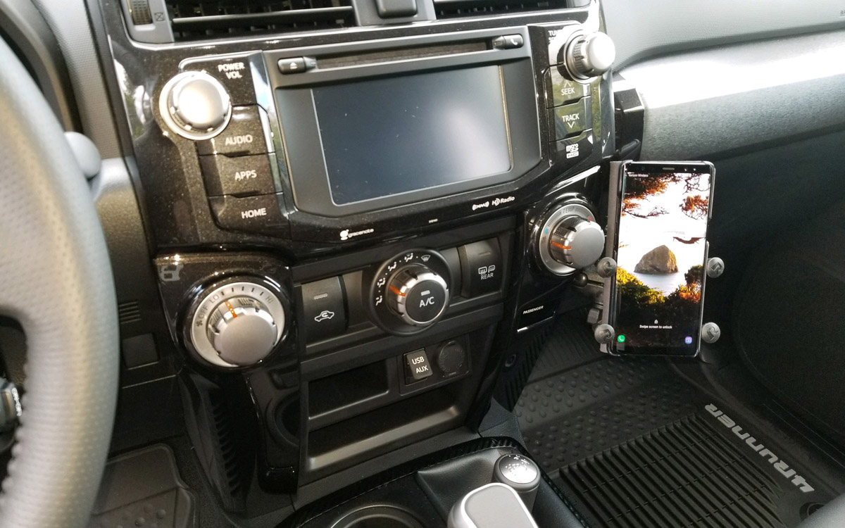

Here it is with my phone the way I like it and been driving around for a week this way so super solid and works great for me.
Here shows how the glove door notch clears the mount arm.

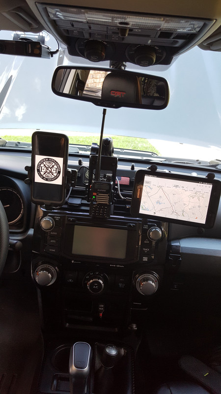

I had Pro Clip's vent mount in my T4R for a while. Worked great except for blocking the driver's side vent. I recently switched to an Expedition Essentials T4RPAM unit, it's awesome. If you're willing to drill into the dash pieces, why not go big...lol
Seems like the airbag would cause that tablet to be a projectile.
Living in Arizona makes it impossible to have anything mounted that high. Unless you have heavy tint on the front windshield or CRANK your AC everything overheats way to quick! Even my tablet that's mounted by my shifter overheats.
